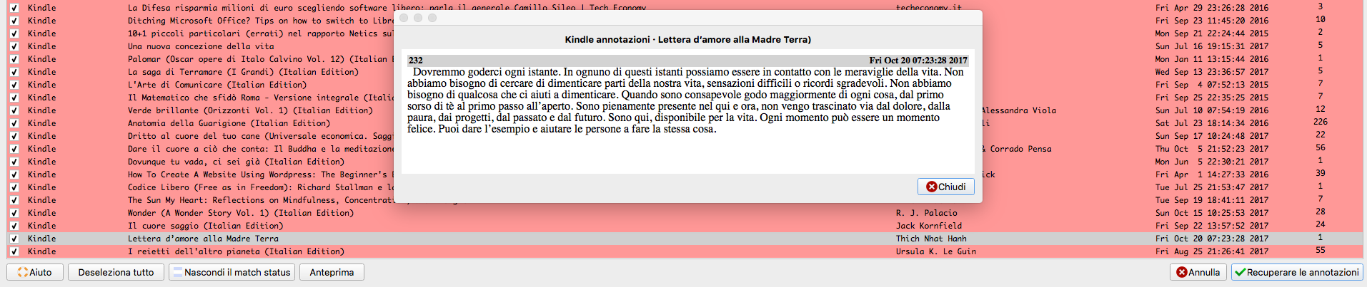

Hi David,
I would like to ask you to have a look at the attached log before making the release. Since the latest betas I thought the plugin works fine but yestarday I tried to fetch the annotations from a recently added book downloaded from Amazon and then added to the Calibre library. It is in kfx format. May be because of the inversion of first/last author name it did not get matched, so I synchronized it in the way you explained to me. You can see in the attached screenshot it is matched now. I then restarted Calibre in debug mode.
Looking at the log I can't understand why the book seems to be recognized, yet when the annotations are found no associated book is found. I attached also the fragment of the MyClippings file.
Do you have an idea why is it happening?

Originally Posted by dsestero View Post
Hi David,
The following entries in the log are the relevant ones:
DEBUG:   54.2  resolve_paths. id=505, path=/<storage>/Nhat Hanh, Thich/Lettera d'amore alla Madre Terra (Italian Edition) - Nhat Hanh, Thich.bookmark
DEBUG:   54.2  resolve_paths. fmt=[u'azw3', u'kfx']
DEBUG:   54.2  resolve_paths. looking for book on device: book_path=/Volumes/Kindle/documents/Nhat Hanh, Thich/Lettera d'amore alla Madre Terra (Italian Edition) - Nhat Hanh, Thich.bookmark
DEBUG:   54.2  resolve_paths. looking for book on device: this_fmt=/Volumes/Kindle/documents/Nhat Hanh, Thich/Lettera d'amore alla Madre Terra (Italian Edition) - Nhat Hanh, Thich.kfx
DEBUG:   54.2  resolve_paths. looking for book on device: this_fmt=/Volumes/Kindle/documents/Nhat Hanh, Thich/Lettera d'amore alla Madre Terra (Italian Edition) - Nhat Hanh, Thich.azw3
DEBUG:   64.3      Have possible book with path=/Volumes/Kindle/documents/Lettera d'amore alla Madre Terra_B018EMPPCI.kfx
DEBUG:   65.3  Book on device title: 'Lettera d’amore alla Madre Terra'
DEBUG:   74.7    Annotation for Title=='Lettera d'amore alla Madre Terra (Italian Edition)'
DEBUG:   74.7      Title not found in books on device
The title in the clippings file is "Lettera d'amore alla Madre Terra (Italian Edition)". The title in the books metadata is "Lettera d’amore alla Madre Terra". The plugin is does a first match using the title. That isn't matching, so it doesn't go to the next step with these annotations. So, the version of the book you made the annotations against has "(Italian Edition)", but the version you sent from calibre doesn't. A test of this would be to edit the clippings file and remove the "(Italian Edition)" from the title.
Well, the fact is that book was downloaded from Amazon and annotated. When I imported it in the Calibre library I resisted the temptation to strip out the '(Italian edition)' just to have the possibility, afterwards, to match the annotations. You can see that part of the title was retained in the metadata in the Calibre library from the screenshot I attached to the previous post. Now I tried three things:
  1. to replace the title with the one with '(Italian Edition)' stripped off in the MyClippings file, as you suggested, but nothing changes;
  2. to change the metadata in the Calibre library to match those on the device (hence removing '(Italian Edition)' from the Calibre metadata) but nothing changes either;
  3. to synchronize the book on the device to that in the library and even this solution doesn't work
What do you think about it?
The non-matching is caused by the apostrophe. I didn't notice this before, but the apostrophe in the clippings file is a single straight quote. The one in the title of the book you sent is a "curly" apostrophe. You should be able to see the difference in my post above. This is in addition to the "(Italian Edition)" not matching.
That is a real pain that I hadn't thought about. I might try "dumbing down" the titles before matching them. If I convert them to lower case and to plain ASCII, it should improve the matching. That would be doing the what calibre does when generating file names from title, plus the lower case.
But, for curiosity, could you add an annotation to the book now on you Kindle? I'd like to know what is used in the clipping file. I can see some accented letters in the log, but I would like to know exactly what the device uses before going ahead.
Also, if this looks like it will take a bit of time, I will probably release the plugin as is and then fix this later. I think were the plugin is now, it is working better than the current release version. And gets the translations out to anyone who wants to use them.
Correct!
It sounds to me like a very good idea!
OK. I did another annotation that you can see below, but please consider that it is the same as the previous ones because that book was never sent to the device from Calibre but only downloaded from Amazon:
Lettera d'amore alla Madre Terra (Italian Edition) (Nhat Hanh, Thich)
- La tua evidenziazione alla posizione 265-268 | Aggiunto in data domenica 22 ottobre 2017 16:27:40
assaporare ogni respiro. Contiene azoto, ossigeno e idrogeno, così come altri oligoelementi, quindi ogni respiro che incameriamo e buttiamo fuori racchiude la Terra. Con ognuno di essi ci viene ricordato che facciamo parte di questo bellissimo pianeta che dà la vita.
Furthermore, I tried to change one annotation in the MyClippings file replacing the straight quote with the curly apostrophe and, even without changing the metadata in the Calibre library (where in the title there is the straight quote), the plugin matched the annotation, as you can see in the attached screenshot!
Of course, it is much much better and functional now; thanks a lot for all the work!
