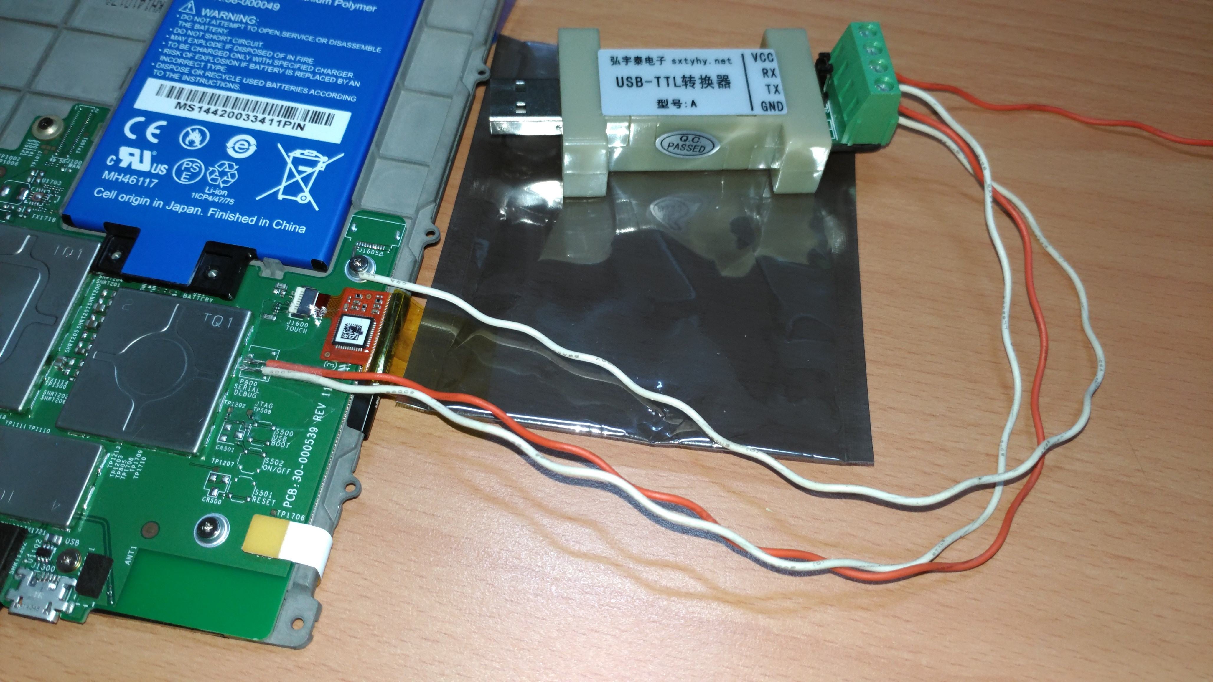

I have exactly the same situation.
My kindle is Paperwhite 2 (6th Gen.). Connect to PC displayed as "SE Blank MEGREZ".
I got the USB-Serial Converter, not the one in the debrick post on this forum, but it's suggested by a blog post in Chinese which also about repairing Kindle. I tested it to make sure the loopback is working on 2 PC, Windows 10 x86 and Windows 10 x64.
I connected the pins and no any output on Putty when I press the power button. I swapped the TX and RX pin but still no luck.
Attachment is the pic.
vinix is offline   Reply With Quote
We only support ours, we do not support anything/everything people can find on the 'net.
(If you where using our directions, it would be immediately obvious that you had Tx, Rx interchanged when you took that picture.)
Get your support from the site you got the directions.
Even their picture is quite clear about how to hook up the adapter, so follow their directions, get your help from them when you can't follow their directions.

I'm sure that the USB to Serial Converter is working by linking its RX and TX and typing. What I typed is on screen of Putty.
Now I connected the converter to Kindle, hold the power button until LED is blinking, and nothing displayed. I swapped TX and RX pin, still nothing.
So, is there anything I can do?

You can not wait 4 months between test / attempts to get the serial port working.
Your battery has run down now.
Recharge the Kindle.
Use a wall charger, not a PC to recharge it.
Use a known good USB cord.
The default (what the device will be using) charge rate is extremely slow, so leave on the charger for at least three days.
Keep that in mind if you only intend to post once every 4 months.
Once you get the Kindle fully charged, then check the ground lead.
Make sure that you have nothing other than:
Tx -> Rx
Rx <- Tx
Gnd <> Gnd
connected.
That is only those three leads, in that specific connection.
You can find pictures with labels of the connector pinout pads in our serial port references (they are all the same, since the K4).
Do not wait 4 months to respond.

First, sorry for the delay, and appreciated your reply.
The battery was removed from Kindle for charging using a universal battery charger and stored in a anti-static bag since then. Before I began this time, I've tested the battery with multimeter and got 3.9v so I believed it is still full.
I'm sure I connected all 3 pins you said and no message displayed in Putty. So I swapped Tx and Rx, still no luck.
Thanks for pointing out the possible problem. I will recharge the battery and try again.

The battery, when fully charged, has a terminal voltage of 4.2 volts (assuming your multi-meter is correct).
Just because you don't like my answer does not conclusively mean that I am wrong.

It is active immediately (a few thousand cpu cycles) after power-on.
The SoC on-board rom code uses it.
You should be using a 1.8 volt, low voltage interface level.
The baud rate is not 19200, and never has been.
Use:
115200, 8N1, no flow control

Sorry, I tried charging PW overnight and the voltage is 4v. I connected the converter, disconnected and reconnected the battery and still nothing.
No output in Putty:
The images above is modified so the size is in permitted value.
