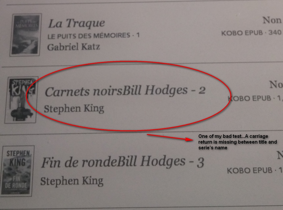

I have a problem to include series info with my Kobo Aura 2... It worked for some books but I dont remember how I did it, now it doesnt work anymore ! I tried many kind of formula with series and title, nothing works... In the Metaboard plugboards, i tried : Format : epub Device : 2 choices : KOBO and KOBOTOUCHEXTENDED with KOBO choice :I never had a serie in the title with KOBOTOUCHEXTENDED I have had serie in title BUT the template are not good... I want this template on 3 lines : Title (big character) Series name - nb_serie (small character) Author (small character) You can see the result here : Unfortunately the template given by the author of the blog doesnt work and dont show the expected result : {title}{series:| – |}{series_index:0>2s} I tried {title}{series}{series_index:| - |} but It doesnt work... Any help ? Thanx ! Last edited by issybird; 05-02-2017 at 02:16 PM. Reason: Oversize image thumbnailed. |

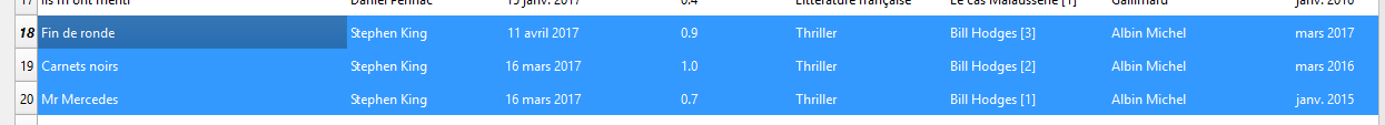

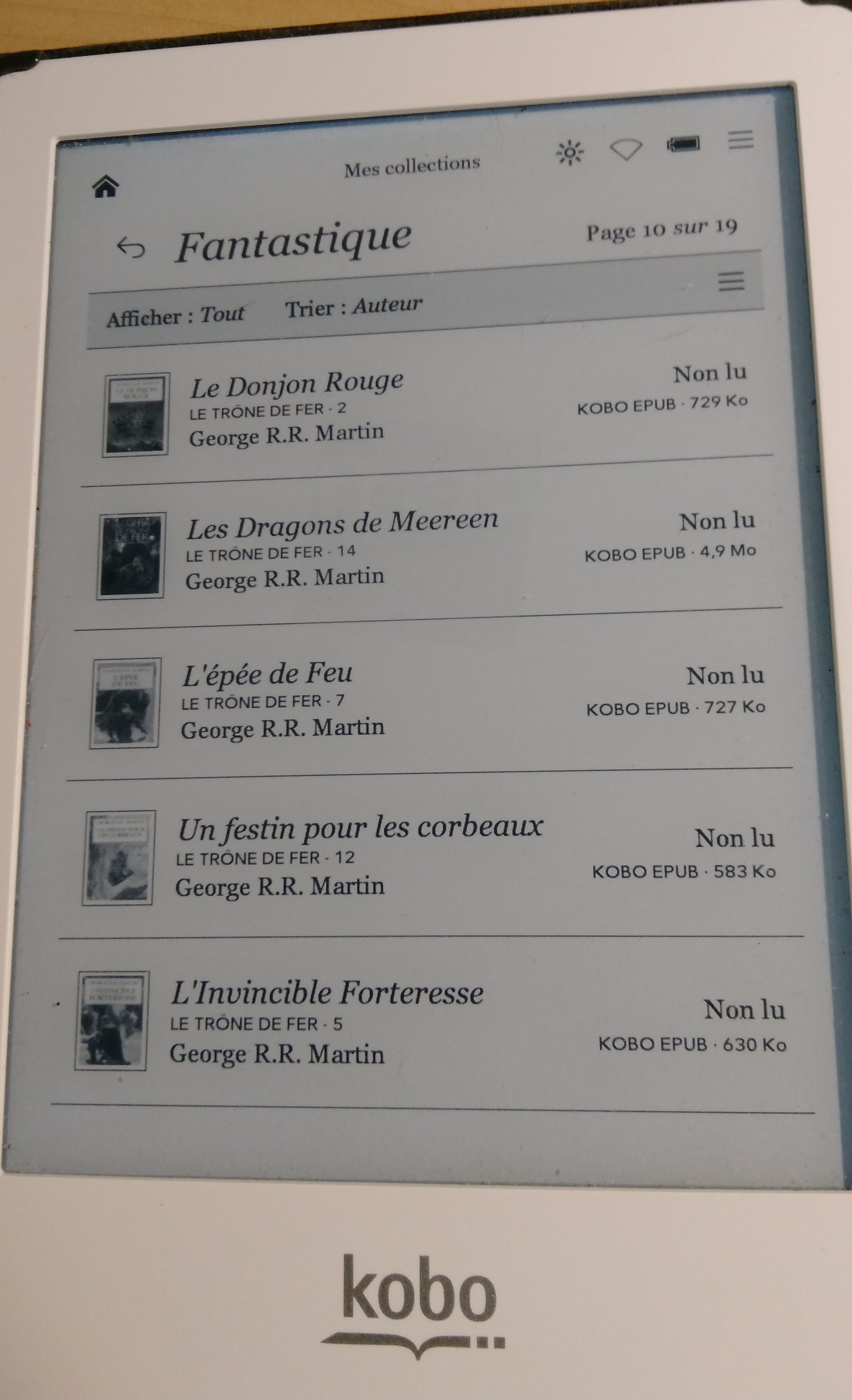

Below is the "default" series result without using metadata plugboard. The serie's name and serie's number of the book DOESNT appears... Above is the result I obtained weeks ago but I dont remember wich formula I used in the metadata plugboard ! Here is a test but a carriage return is missing between title and serie's name : Here is a screenshot of my Caliber, you see that series info are right but dont appears in the list without using metadata plugboard : Anyway thanks for your help Last edited by issybird; 05-02-2017 at 02:20 PM. Reason: Oversize images deleted since OP provided thumbnails. |

Ahhh! The series info displayed on the list is not put there by a metadata plugboard. The Kobo devices support it, but do not read it from the metadata. The driver will check each time the device is connected and update the database on the device if there are changes. It can't do this until the books have been processed by the device into the database. So, it should be updated the next time you connect the device to calibre. But, it requires the driver to be configured to do this, and, for the "Metadata management" management option on the "Sending books to devices" page of the calibre preferences to be set to automatic.
