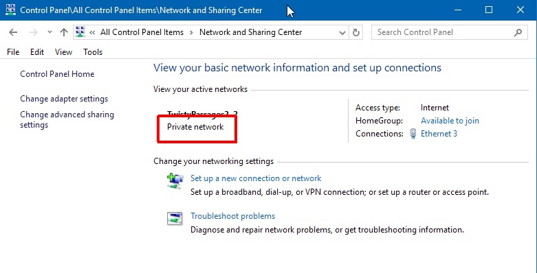

  2. FAQ step 1.1: Post a screen capture of your Windows 10 network settings "Network and Sharing Center" so we can verify that you are using a private network.
    Attachment 159368
