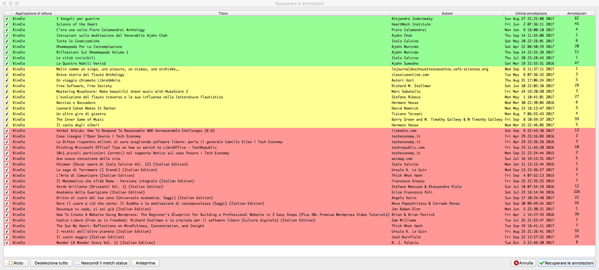

Good job David, we are getting closer.
As you can see from attached screenshot, now the plugin finds more annotated books. For example, it now finds KFX books downloaded from Amazon.
Yet, some annotated books are not found. I can't understand, for example, why it don't find the annotated book 'Ecologia affettiva' that I sideloaded from Calibre to the device in plain AZW3. It has a lot of annotations, as you can see from the MyClippings.txt that I have uploaded in a previous post.
Furthermore, it seems that selecting more than a book yelds an error and no annotation get fetched. I tried to select 7 out of the 9 green titles and push the button 'Fetch annotations' than I got the following error:
Great!
The clipping file seems to have that book with the title "Ecologia affettiva (Italian Edition)". But, the metadata coming from the book seems to be "Ecologia affettiva". What does the Kindle display as the title? I'm wondering where the "(Italian Edition)" comes from.
The error seems to be happening in the code to merge old annotations with the new. Someone reported that recently and it was because the existing annotation had been edited and wasn't complete. Are you sure it is happening when multiple annotations are selected, or when a particular annotation is selected? Or there might be more than one that is bad.
Can you have a look and tell me? And if there are, can you copy the HTML code for the annotation and send it to me. I'll have a look at it and see if I can come up with a solution that doesn't lose anything.

Great!
OK, you got it! The '(Italian Edition)' in the clippings files comes from the fact that I annotated the book after downloading it and so it doesn't matter if afterwards I replaced it with another version with updated metadata.
What now I clearly understand is this: the plugin looks for books which should have the same title in all three places: 1: the metadata in the Calibre library; 2: the metadata on the device; 3: the clipping file. Perfect, now I have a clear rule that I didn't understood before.
