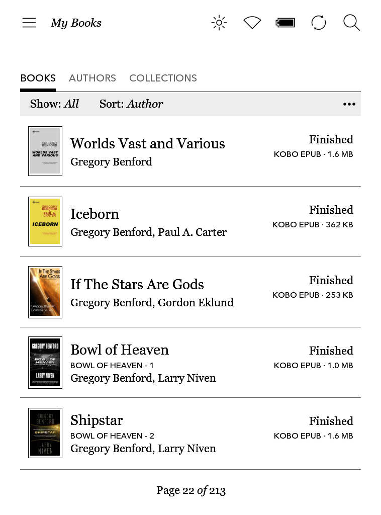

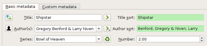

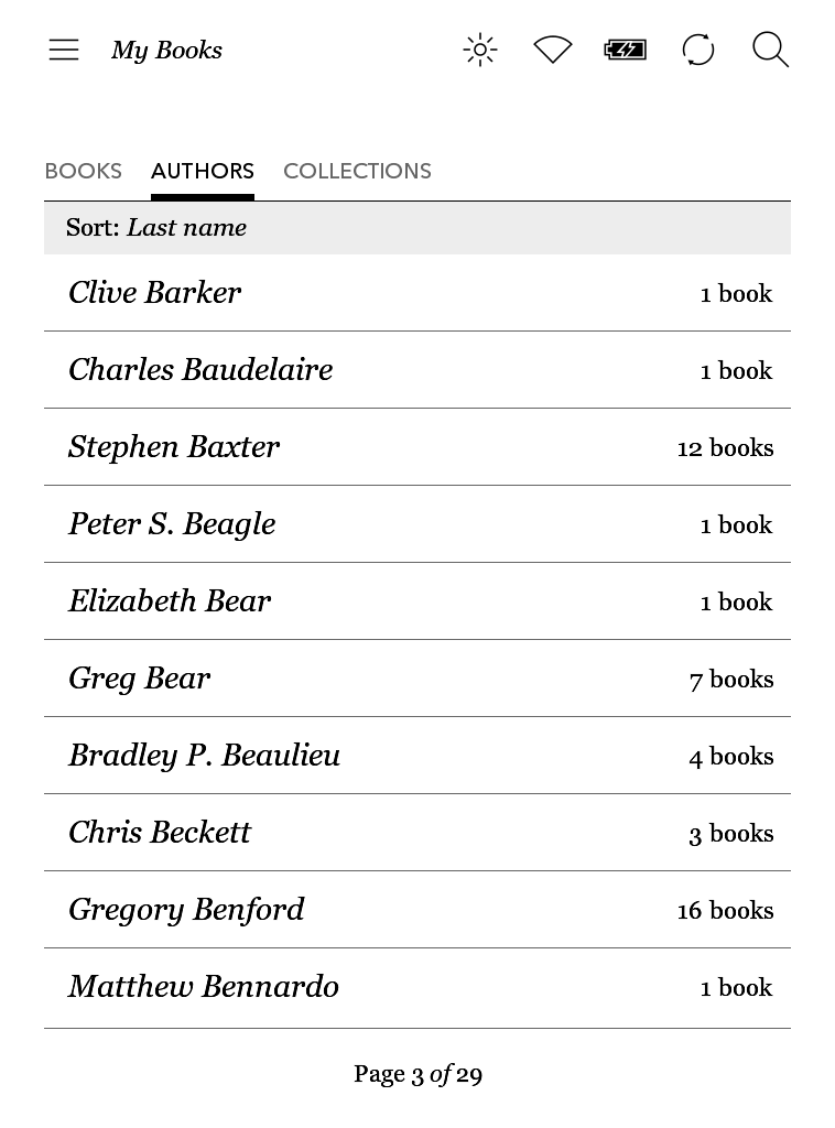

Here are screenshots from my Glo showing the results of using the plugboard: program: raw_list('authors', ', ') with destination authors.
The authors list splits the authors at the comma, so that each author has their own entry in the authors list. Hopefully Kobo will rethink this flawed design, but for now I don't think there is any way around that if you want the authors list to work properly.
ID:	158916   Click image for larger version
ID:	158917   Click image for larger version
