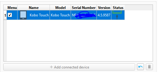

hey guys I'm with my kobo touch connected and the status from the plugin doesn't show the green arrow when it is connected. But it is still backing up. I just wanted to know if is normal.
No, it's not normal. I'm hoping I didn't break this with the fix I put into last nights release.
There does seem to be an icon in the last column, but not the expected one. And none of the buttons below the list are enabled. Can you try clicking somewhere else in the list and then back on the device and seeing if any of the buttons become enabled?
As to the backup still being run, do you have the backup configuration to be for individual devices? If you don't, then the backup is run whenever any Kobo device is plugged in. The device not being in the list is OK for that configuration.
The only button that works is the one to rename the device. Even if you click in other parts of the window or uncheck the device it won't enable the other buttons. My configuration is for each device(but I just have one haha)but like I said the backing up is working fine.
OK. I was fixing a problem with no devices in the list. It did seem to be working when I have all my devices defined, so I might have broken when there was only one. I'll have a look at it tonightl.
Like you said it must only be the icon image. But to be honest I noticed this thing before you update your plugin.
Actually it is normal for the icons. Blas seems to be using my Highlights icon them in calibre, so every icon is different not only this one.
And it the icons changed the moment the theme was applied, it has nothing to do with the plugin update.
If the icon is not explicit enough I will change it next time I update the icon theme.
