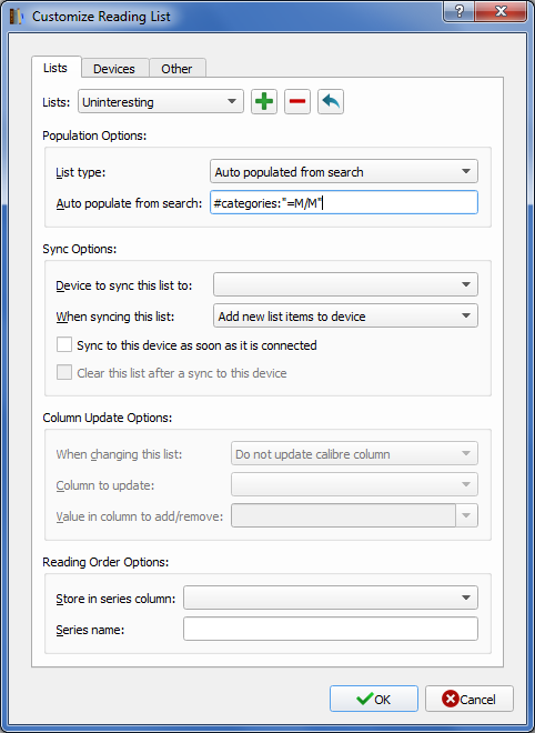

Old 03-15-2018, 03:29 AM   #776
Tanjamuse
Posts: 1,327
Karma: 5306
Join Date: Jan 2014
I've tried creating a RL by search but I don't understand how to tell it which list-column to update.
Name:	Skærmbillede 2018-03-15 07.25.48.png
Old 03-15-2018, 07:09 AM   #777
davidfor
Posts: 24,905
Karma: 47303828
Location: Sydney, Australia
Sorry, I'm not sure what you mean.
That list should show you all the same books as if you had typed "M/M" into the search bar. But, based on your question earlier, you might want to use something like '#mycustomcolumn:="M/M"'. The name you use is whatever you put into the "Lookup name" when you created the column.
Is that what you want?
Old 03-15-2018, 07:23 AM   #778
Tanjamuse
Posts: 1,327
Karma: 5306
Join Date: Jan 2014
What I want is an automated job that when I add M/M in a custom column then it would be end up on a specific reading list.
Old 03-15-2018, 07:35 AM   #779
davidfor
Posts: 24,905
Karma: 47303828
And what I suggested will do that. When you display the list, the search entered is run and only the books matching the search are displayed. What do you want other than that?

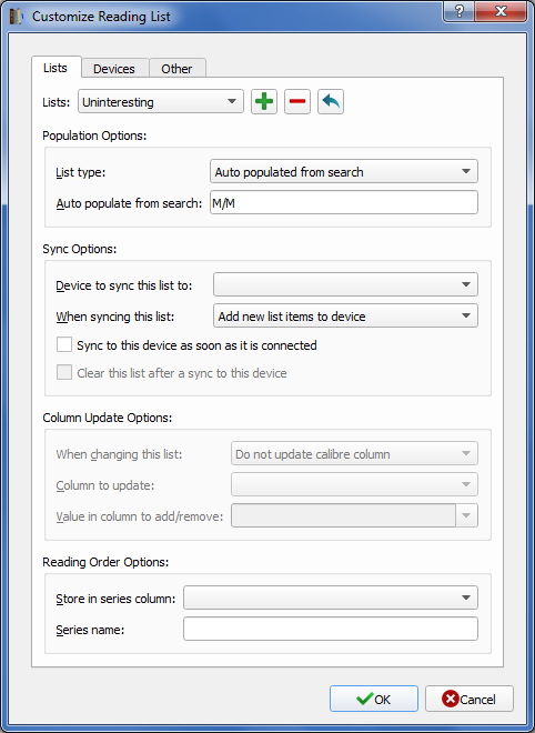

Old 03-15-2018, 07:44 AM   #780
Tanjamuse
Posts: 1,327
Karma: 5306
Join Date: Jan 2014
When I choose auto populated from search, I can't choose which column I want to add value in.
Also, I don't want to add the list to any device.
Name:	Skærmbillede 2018-03-15 11.42.40.png
