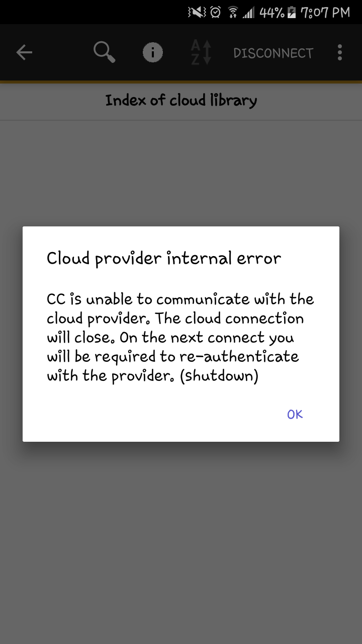

So I've connected my CC app to my Calibre library through cloud connection before, but after I had to factory reset my phone, I tried to resign into my cloud connection, and got an error message about not being able to communication with the cloud provider. I am using OneDrive as the cloud provider, and I am signed onto my OneDrive account separately elsewhere on my phone, so I am confused about the "not being able to communicate" message.
Attached is a screenshot of the error message. Any help would be appreciated. Thank you very much.

I can still connect to Onedrive, so it should work.
It is impossible to know what might be happening from that error message. It looks like Onedrive refused to let CC "see" the storage. Are you sure you used the correct username and password? Did you try more than once?
If you send me a CC debug log then I might be able to say more. See our FAQ How do I get help? for instructions on how to do that.

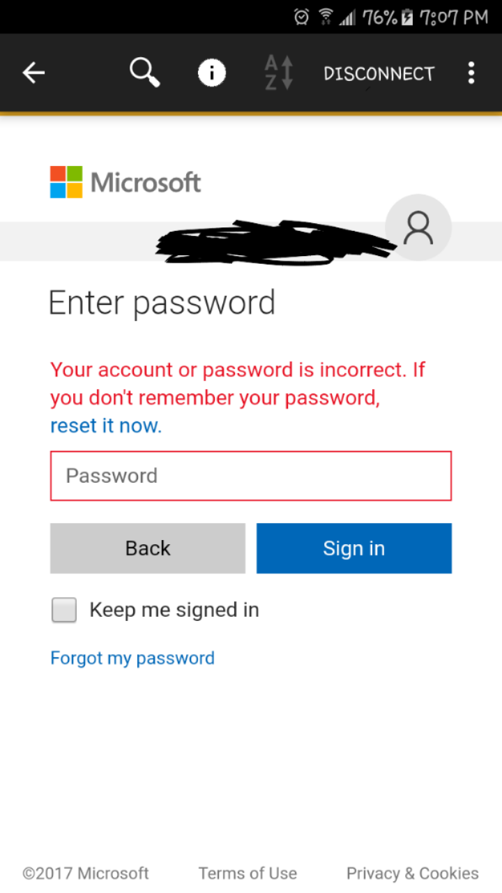

Sorry for the delay, just got home from work and on the computer.
Just tried another password. Doesn't give me the same error message, gives me a "your password or username is incorrect" message on the sign-in page. It seems like it starts to connect, and for some reason can't. Sending you debug log shortly. Thanks for the help!
Not to worry about the delay. Life happens.
The debug log says that CC was prevented from connecting to OneDrive when trying to get a list of folders. I don't know why that would happen.
