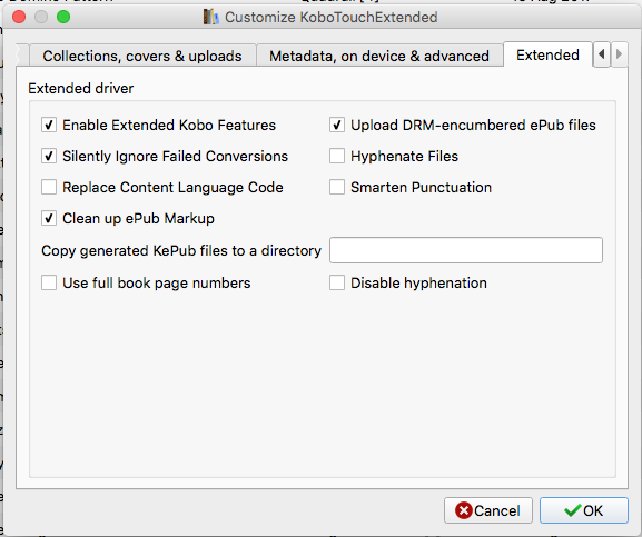

Old 08-26-2017, 12:36 AM   #1715
reinhardtjh
reinhardtjh began at the beginning.
Join Date: Aug 2017
Device: Kobo Aura
I have had a Kobo Aura since 2015. And sometime in April I upgraded the firmware to the new 4.x series, currently 4.5.9587. I went a few weeks before adding any new books, but when I finally did, i started getting this error on "Send to Device"
calibre, version 3.7.0
ERROR: Error: Error communicating with device
This file is locked with DRM. It cannot be edited.
  File "site-packages/calibre/gui2/device.py", line 88, in run
  File "site-packages/calibre/gui2/device.py", line 592, in _upload_books
  File "calibre_plugins.kobotouch_extended.device.driver", line 335, in upload_books
  File "site-packages/calibre/devices/kobo/driver.py", line 2014, in upload_books
  File "calibre_plugins.kobotouch_extended.device.driver", line 179, in _modify_epub
  File "site-packages/calibre/ebooks/oeb/polish/container.py", line 1165, in __init__
  File "site-packages/calibre/ebooks/oeb/polish/container.py", line 1237, in process_encryption
DRMError: This file is locked with DRM. It cannot be edited.
I fussed with it for quite a while, going so far as to reset my Aura to factory setting, deleting all books and starting over but still I got the error - even on books I'd previously (before the firmware upgrade) loaded with no problem. Not on every book but most of them. I finally switched the Calibre driver back the "main" Kobo driver and no error. Books that would not load, did. So I switched back to the extended driver and I get the error. So whatever it is, it's something between the extended driver and the newer firmware on the Aura.
I watched here to see if anyone else would report it but I haven't seen it (or I missed it). So could it be something that I'm doing?
Thanks in advance for any help.
John H. Reinhardt

Old 08-26-2017, 01:38 AM   #1716
davidfor
Posts: 24,905
Karma: 47303826
Location: Sydney, Australia
Sorry, but the message tells you exactly what is wrong: "This file is locked with DRM. It cannot be edited.". You need to removed the DRM, or select the option in the driver to "Silently Ignore Failed Converions". That option means the books with DRM will be sent as epubs. The KoboTouch driver works because it does not attempt to change anything in the ePub that is protected by DRM.
And just to be clear, this has nothing to do with the firmware version on the device. Or the version of calibre. This is independent of the device and if you tried to open the book with the calibre viewer or editor, you would get a similar message.
Old 08-27-2017, 10:44 AM   #1717
reinhardtjh
Join Date: Aug 2017
Device: Kobo Aura
Thanks for your information. I probably broke the cardinal rule of changing only one thing at a time and loaded new firmware onto the Kobo, changed the driver in Calibre and who knows what else all at the same time. Other things changed on my Kobo at the same time so I attributed it to the new firmware. Books that I had previously loaded and erased, now failed to load, but I must have loaded them with the "normal" driver and switched to the extended at some point later on.
I must have something else set wrong as the "Silently Ignore Failed Converions" option is checked (as shown by this screen shot) and still I get the error. Maybe it's the "Upload DRM-encumbered ePub files" I'll have to disable that and try.
It's interesting that it only happens with most Adobe DRM file, but not all. They must use differing versions of DRM.
At least I know the cause and can work around it now. Thanks!

Old 08-28-2017, 08:22 AM   #1719
davidfor
Posts: 24,905
Karma: 47303826
Firstly, you are right, it is the "Upload DRM-encumbered ePub files" option. I have no idea how missed it when I looked before.
The upload should fail for all books in the calibre library that have DRM. A likely reason is that something has happened to the DRM removal plugins so that when you add books to the library they don't get the DRM stripped. Try opening the books that have the problem with the calibre viewer. If they still have DRM, the viewer will display DRM error.
And, as you have discovered, the option isn't working. I've just tried it and see the same error for a book with DRM. Looking at the code, something has changed in the underlying calibre code for opening a book for changing. It shouldn't be to hard to fix. I'll try and look at it sometime this week.
