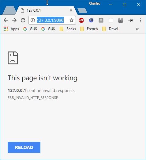

If on your laptop in a web browser you connect to 127.0.0.1:9090 you should see something like the following (I am using Chrome). Note the "invalid response".

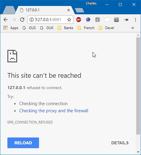

If you connect to 127.0.0.1:9091 (an invalid port) you should see something like this. Note that "site cannot be reached".

If you get "site cannot be reached" with port 9090 then something on your laptop is blocking that port. That "something" is local to the machine because 127.0.0.1 addresses do not go through the external network.
If you get "invalid response" with port 9090 then try the same thing from your Android device, but using 192.168.... (the laptop's IP address) instead of 127.0.0.1. If you don't get "invalid response" then something on your network is blocking access to that port. That "something" can be your router, the dongle, or the firewall.
If you get "invalid response" then try CC. It should work.
