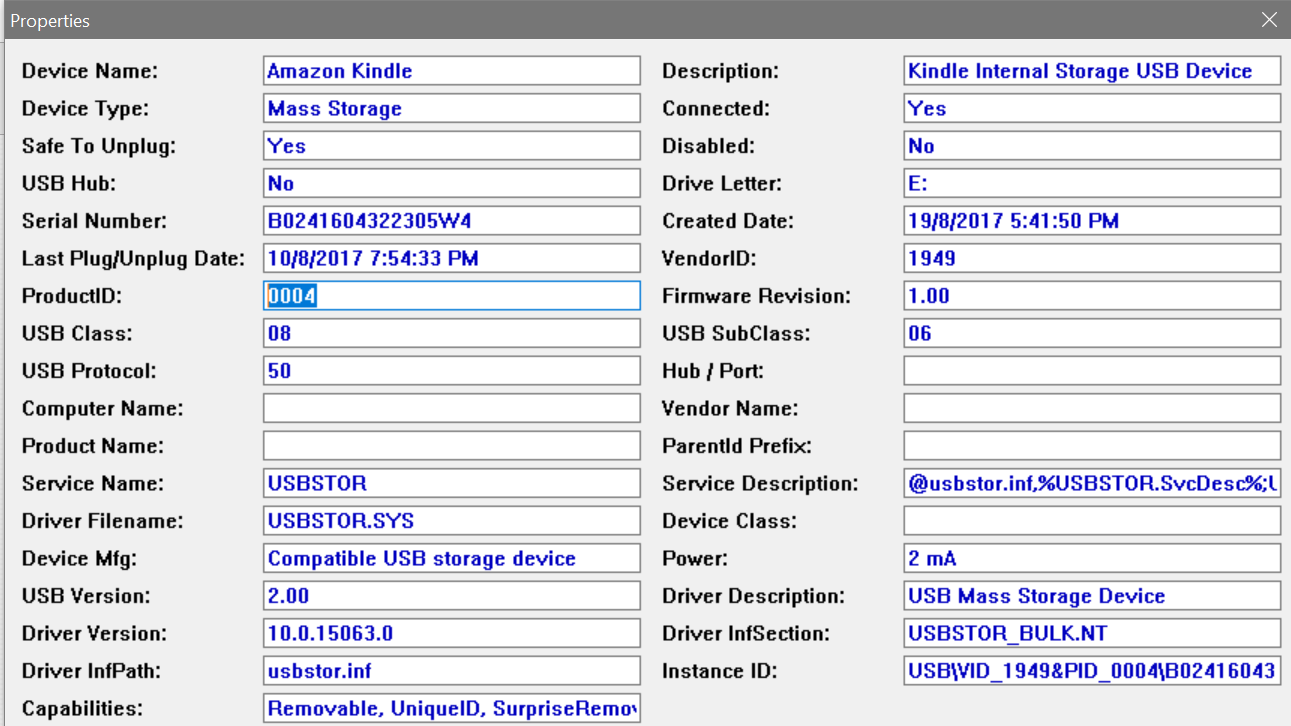

I've also tried to use USBDeview, attached is the screenshot of Kindle, after plugging it in.
