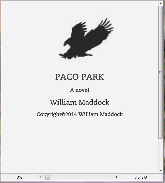

The test epub just contains just one image coded thus:
<p class="scrivener5"><img alt="" src="../Images/eagle.jpg" style="width: 50%;height: auto;"/></p>
Please also note in the above code that I'm using inline styling with percentages. It also appears that everyone is seeing this image too on their KP and KP3 eInk displays. Right?

Here's the oddity explained: Everyone has been saying that images dimensions defined in percentages within an image tag cannot be displayed on older KF7 devices. But when Hitch and I look at the KF7 displays for the test epub we both see the image(formatted with % dimensions) plain as day. Well, according to what everyone's been saying -- you should see no image if you code your image using percentages on KF7 devices. Right?
No. This is a misunderstanding. I said, the coding CANNOT be used, because it doesn't work. The image displays at the wrong size.
All you have to do to confirm my findings is just open the test epub in KP and KP3 and then just report back here if you see a centered image or not in their eInk displays. And please don't complicate things by dragging in image sizing, positions etc in your observations -- the latter is completely irrelevant to this test. This test is only meant to prove or disprove whether using inline styling(with % dimensions) will display ebook images correctly on KF7 devices.

I don't think you read my post. My observations have NOTHING to do with your plugin. The image from your test2.ePUB, that you think is showing correctly, isn't. Period. It's not remotely 50% of the screen. I discussed, in pixel-detail, the white space on the left side of the image, too.
I used YOUR coding, inline. I tested YOUR ePUB. It's not displaying correctly in KF7. That's it, William. It has nothing to do with the plugin.
ETA:
Please go back, William, and read my post 72: https://www.mobileread.com/forums/sh...8&postcount=72 . The first paragraph of my response talks about the plugin--but the rest is ALL about nothing but KF7 and how the images display.
View the KF7 image, of which I've taken a screenshot, in that post. Not even you can assert that that image is remotely 400+ pixels wide, which is what it would have to be, if it were obeying the instruction, the inline instruction, that you're saying works. It doesn't. It's not an anomaly. You're seeing something incorrectly.

It's also plain to see that you only tested the epub on the old KP app. And you obviously haven't yet tested that epub on the newer KP3 app. I've now shown you that the KF8 and KF7 displays on the KP3 app are the same size(because both screen widths and both images are exactly the same size) on my tests which was the expected result. This directly conflicts with your own test results on the old KP app(which I have never really trusted).
You could of course actually try loading the mobi version of the test epub into your old eInk device and have a look. But, unfortunately, there is no way that I can see how you could accurately measure the image width(ie by measuring the larger but invisible white canvass background) on your device accurately. Over to you.
I hate to break it to you, William, but we don't use the KP3 app, here at my company. (Other than for Fxl file previews). Why? Because it is NOTHING like the real devices--any of them. It's NOTHING like the PPW/Voyage/Oasis devices, nothing like the Fire. AT ALL. I mean, it is crazy-wrong. We have to have this freaking conversation with Mac user clients, who dl that STUPID app, all the time, about how what they're seeing has no basis in reality. You're using it to guide what you're doing, programmatically and coding-wise, around Kindle? Jesus, no wonder your mindset is screwed up.
And THAT's what you're basing this one? I have other news for you: the "Kindle eReader" emulation, on the KP3, that you are placing all this faith in, as a "good" emulation of a KF7?
It's not a KF7 emulation AT ALL. Not one iota.
It's intended to be emulating the PPW/Oasis/Voyage devices, WHICH ARE KF8.
I literally cannot believe that this entire discussion, this entire disagreement, is based on this totally incorrect misapprehension of yours. I'm NOT going to sit here and try to convince you of this--email Amazon. Go right ahead. I cannot BELIEVE that I've wasted all this time, because you made a totally incorrect assumption about what is what in KP3. Email them, and waste your and their time, since they made this POS app. I've wated enough of mine on this.
There IS no KF7 emulation on the KP3. Not at all.
Didn't you notice, William, that the "Kindle e-reader" emulation, on KP3, has FONTS? Which, we all KNOW, are not available on KF7? What, you saw that and decided it was KF7, any-damned-way?
Jesus, what a freaking waste of our time.
And no--I'm not going to sit here and take screenshots off devices, just to prove it to you. I've already sat here, done all this "testing," took screenshots, etc., because you made an assumption, that not only was totally wrong, but was completely and totally counterindicated, if you had JUST LOOKED AT THE OPTIONS ON THE EMULATION. Like FONTS!!!
You want to be a programmer? Around Kindle devices? Then bloody BUY ONE. This is an absurd, annoying, infuriating waste of my time.
FFS!
I'm now officially and totally DONE with this discussion. UNFREAKINGBELIEVABLE!!!

@Hitch...You are right about what you say. My sincerest apologies for that mistake.
And further concerning your wild and unnecessary blast from above, I am also quite relieved about your decision to leave this discussion and will happily comply. And yes, I agree with you, this discussion -- primarily about whether an ebook using inline styling with percentage dimensions displays correctly on KF7s -- is going absolutely nowhere...
But if anyone would like to discuss the new plugin(the original purpose of this thread) -- I would be quite happy to discuss that.

Originally Posted by slowsmile View Post
@Hitch...Just one point from your wild blast above:
Hitch said, referring to the KP3 app:
The following is taken from the KP3's Help doc:
"Not one iota..."? So you're wrong again Hitch.
But if anyone would like to discuss the new plugin(the original purpose of this thread) -- I would be happy to do that.
William:
What the hell is wrong with you? The Paperwhite, Voyage and Oasis are ALL KF8 readers. NOT KF7.
I give up. Go ASK AMAZON. (I'll save you some time. I linked the TECH SPECS, from all three, below, genius.)
FFS. This is hopeless.
ETA: I'm wrong "again?" I am? Have you forgotten that not a week ago, Diap told you that YOU were wrong about KF7 and CSS? Not me? I haven't been wrong, at all. YOU are WRONG here, William. The eInks that you are blathering on about are KF8 devices. Not KF7. And for the LAST goddamn time, if you don't believe me, ask Amazon. Hell, for that matter, ask anyone else HERE, because they ALL know that they're KF7. No wonder you're so screwed up about CSS, etc. Jesus.
Here, genius: since you REFUSE to believe me, maybe you'll believe these guys. AFTER all, they're MEN: http://epubsecrets.com/media-queries...le-devices.php . Scroll down. See PAPERWHITE?
This is the most unfreakingbelievable "argument" I've ever been in. UNFREAKINGBELIEVABLE. It's like trying to have a discussion with a goddamn Holocaust denier. "Oh, see, this list of Kf8 devices PROVES that you're wrong, Hitch!"
How about, the FACT that those devices SHOW FONTS PROVES YOU'RE WRONG, WILLIAM!!!????
I am absolutely gobsmacked at how freaking stupid this is. Wasted everybody's time on this, because he doesn't know what devices support WHICH freaking format. UNF*CKINGBELIEVABLE!
From AMAZON's OWN WEBPAGES:
Scroll down, here, under "Technical Details" for the Paperwhite:
https://www.amazon.com/dp/B00OQVZDJM...s_eink_mt#tech and read, under "Content Formats Supported:"
Kindle Format 8 (AZW3), Kindle (AZW), TXT, PDF, unprotected MOBI, PRC natively; HTML, DOC, DOCX, JPEG, GIF, PNG, BMP through conversion
Or, how about this, for the Voyage: https://www.amazon.com/dp/B00IOY8XWQ...ds_erd_ic#tech
And last, but not least, the oasis:
https://www.amazon.com/dp/B00REQKWGA...s_erd_wky#tech
Now, since those are the goddamn TECHNICAL DETAILS, from AMAZON, itself, will you shut the hell up about how I'm "wrong,"? Or are you actually going to sit there and look even worse than you already do?
All three of those are KF8, LIKE. I. SAID.
Hitch
Last edited by Hitch; 08-17-2017 at 08:26 PM. Reason: I just can't take this. This is idiotic!

I was just about to jump in here pointing out slowsmile's error...but he apparently saw it and deleted the majority of his post.
So back to the original (plugin) question - and in conclusion (I think) -
KF7 % for image width = bad, and putting a percentage for the width (inline or not) that is supposedly calculated for the perfect screen width is useless as it doesn't work. Just put the pixel width/height if it is smaller than the screen.
KF8 % for image width = good, and you certainly don't need to put said percentages as an inline style for KF8 (leave them in the CSS), and said percentages certainly don't need to be calculated to match a specific screen width - you just set 80% when you mean 80%.
So, if the calculated percentage doesn't work on KF7, and you don't need a calculated % for KF8, then what exactly does this plugin DO for those who use Sigil to build ePubs?
