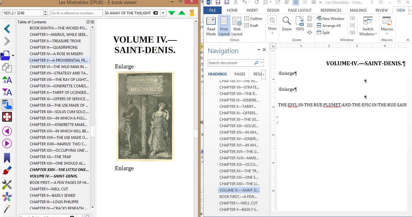

images not imported after conversion from epub to docx using Calibre 3.6(64bit)
Only cover page imported after conversion but other images not included.

After conversion, I've checked job details log but no error mentioned related images.
I'm attaching my debug file of this conversion. Please have a look and give me a solution.

I converted this file from epub to RTF format and the output of RTF has images but some minor image setting needs to be set.
Somehow succeed while converting to RTF but failed in docx without images.

Thanks to all who gave reply.
The problem was resolved by untouched epub file. I've converted the original epub file to rtf file without any modification. Thanks for your support.
