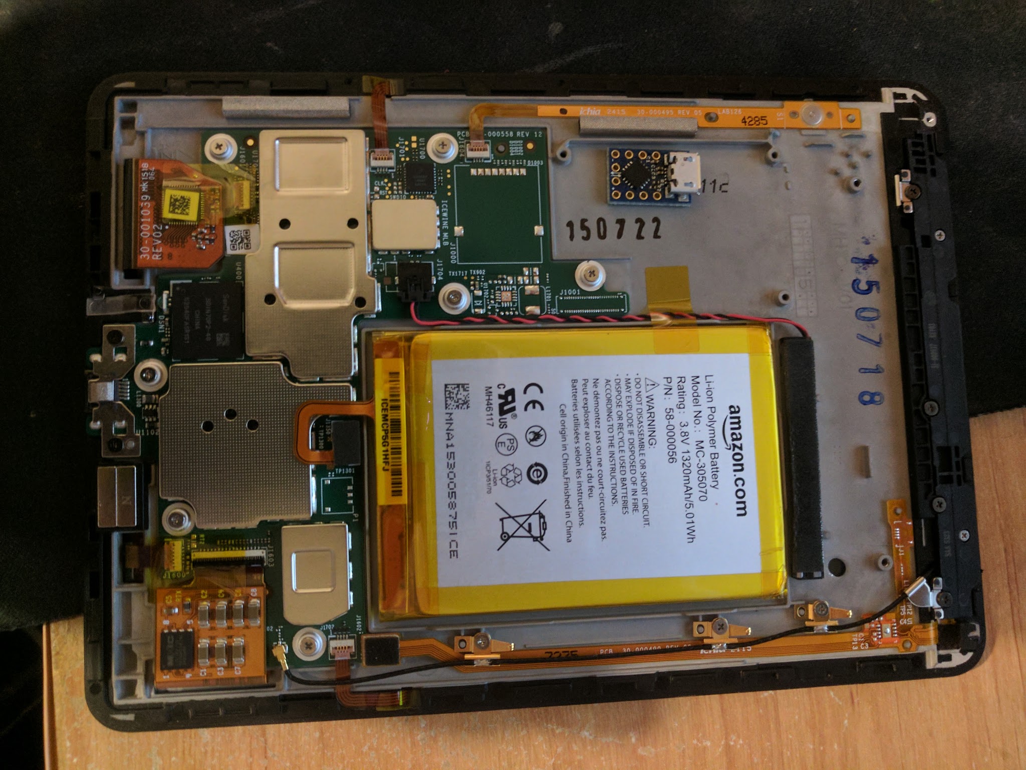

There is a nice big open space next to the battery, but its not thick enough for the jim.sh board. (Mostly because of the micro-usb port. Might fit if it was a center mount instead of top mounted, but )
that big open spot is where the 3g modem would go.

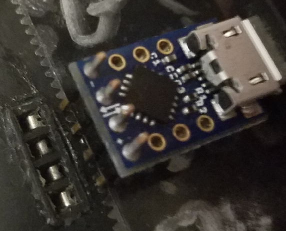

Here is what I have done with mine. I bought a dip socket, and glued it onto the back case.
Then I ran the wires from the serial port to the back case, and "folded' them up so its like a zig zag, so I have room to take the case off.
What you could do instead of gluing to the back case is to glue it to that open ares, and just have a bid of an opening around it for the back case to settle in onto.
Teh metal plate there is probably conductive though, so make sure its on some electrical or polyamide tape. if it fits.
Then my jim.sh I soldered the pin headers to, and I can just slot it into the case when I need it.
Full size to zoom in: http://imgur.com/87DLfVE

yeah, these dip sockets arent terribly thick though, look at this guy that you can cut down to 4 pins.
https://www.amazon.com/FISCHER-ELEKT...dp/B018CQLXTU/
these guys were a lot cheaper at my microcenter, they have a ton of hobby parts like this, then amazon.

The voyage is going to have the 1.8v pin somewhere else too.
This image shows something labeled 1v8 under the pink box, which looks to be avialable even before they removed the shields. On the back that one appears to be the 'MCU_1v8 pin"
https://www.ifixit.com/Teardown/Kind...Teardown/32278 step 11
https://d3nevzfk7ii3be.cloudfront.ne...AAVZXCAkQ.huge
The back of the voyage board looks better labeled, you can see UART_RX and UART_TX here
https://d3nevzfk7ii3be.cloudfront.ne...F6aXWTH1Q.huge ( but even the thinnest wires are too thick to put under the board and screw it back down. and any solder would be way to thick.

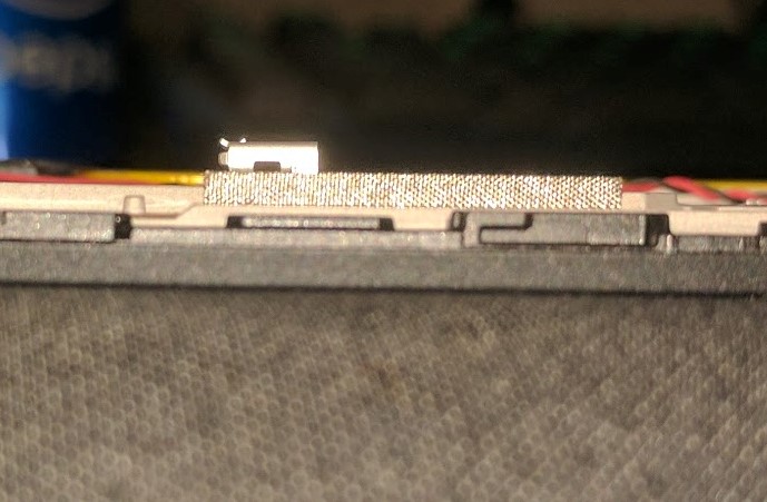

First image shows where I was originally planning to try and put it (roughly), and in the second you can get an idea of how little space is there between the back of the display and the case itself (the back cover rests flush against that silver pad, might even depress it slightly).
ID:	158368   Click image for larger version

Considering the back of the board rests flush against the back of the e-ink display, I would say that is probably correct lol.
