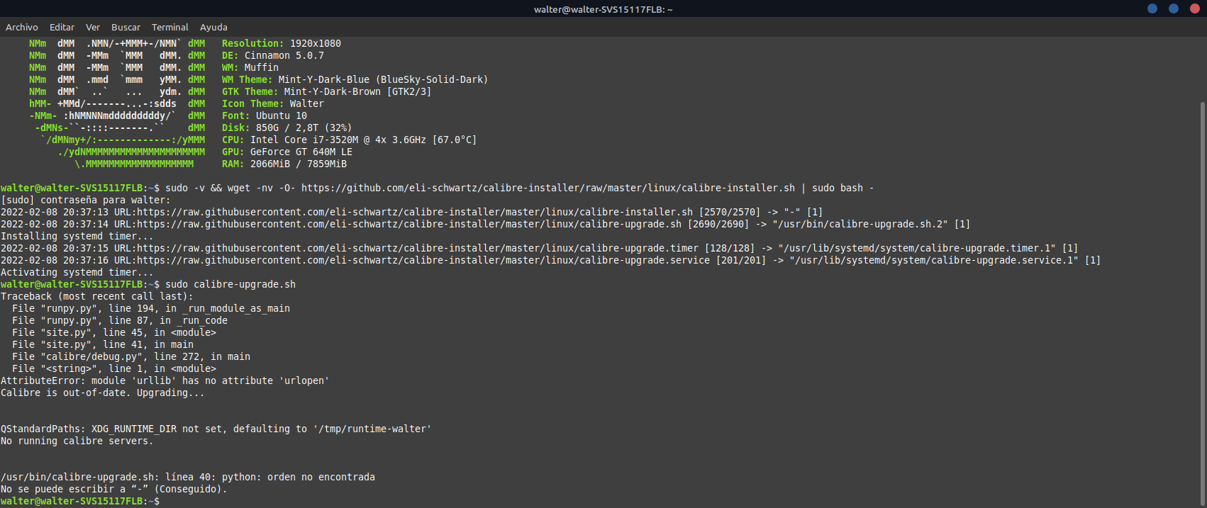

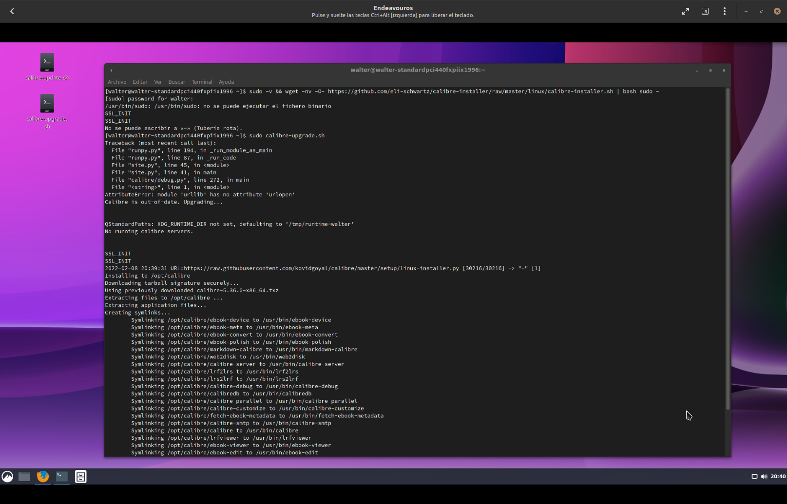

Eschwartz I know it's an old thread but I've tested the script and it works fine on an EndeavourOS distribution, but it gives me an error on linux mint 20.02
walter@walter-SVS15117FLB:~$ sudo calibre-upgrade.sh
[sudo] contraseña para walter:
File "runpy.py", line 194, in _run_module_as_main
File "runpy.py", line 87, in _run_code
File "site.py", line 45, in <module>
File "site.py", line 41, in main
File "calibre/debug.py", line 272, in main
File "<string>", line 1, in <module>
AttributeError: module 'urllib' has no attribute 'urlopen'
Calibre is out-of-date. Upgrading...
QStandardPaths: XDG_RUNTIME_DIR not set, defaulting to '/tmp/runtime-walter'
No running calibre servers.
/usr/bin/calibre-upgrade.sh: línea 40: python: orden no encontrada
No se puede escribir a “-” (Conseguido).
