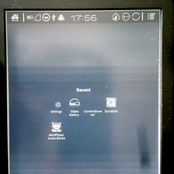

...But as I said, I did not like the type of "recent task switcher" implemented in App Switcher (animations are not EPD friendly), so I developed my own, for the benefit of the community. You can see it still uses the good ideas of Samardžić's - the notification icon, the free memory indicator.
Please find attached 'Boox Task Switcher' - "Boox", since it re-implements the Task Switcher of Android 4.0.4, that we do not normally see on Onyx devices since they miss the "Home" button (the Task Switcher would appear upon long-press of the Home button).
I developed and tested it (<rant>for too many troubleshooting hours, developing for Android seems one of the most uselessly protracted effort ever</rant>) on a T68, I suppose it will work on all other devices/firmwares (but currently forced to 4.0.4, for the weak reason that I cannot test on a higher version).
Usage:
  • start the application to get a new icon in the notification area (it does not autostart, you choose if/when you want it to run - then it stays in the background);
  • tap on the notification area of the status bar an then on the relevant row of the so-called "expanded notification area" to get the "recent task switching" dialogue.
To install, remove the added '.zip' exension, needed to upload here (I cannot directly upload .apk in the forum).
Of course, I take no responsibility etc.
And this is a screenshot of the "recent task switching" dialogue. Having the notification bar clogged with icons, you cannot see the Boox Task Switcher app icon there - but it is not relevant: you just tap in any zone of the notification area which is not a "toggle" (not wi-fi nor bluetooth) to open the "expanded notification area".
