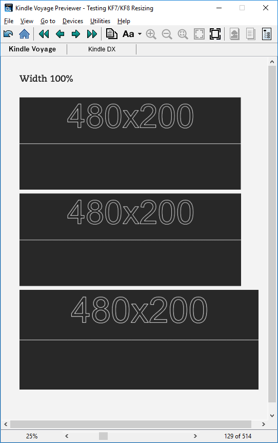

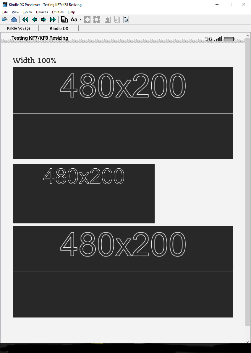

Back on topic, the plugin
Hi:
I can, very quickly, report that there's something hinky, but I don't know the genesis yet. So far, the plugin seems to work well.
I can report that something is hinky with the KF7 DX emulation. Now...this may be something *like* the problem that affected the Voyage--where if you have an image that is > 50% of the width of the screen, but smaller than 100%, it will blow it up to full-width.
I tested an ePUB that I had handy. It had a few smaller images (a line and a copy of the Presidential seal) and then two that were larger. The plugin calculated the two larger images at 797px w, and 444px tall. (I confess a bit of whatever about this--the original image was 827x455, but, hey.)
On the Emulation, the Great Seal (set to display at 300px wide; original image is the same size, unlike the other, above), displays at what I believe it should. Ditto on the K2 Actual. All groovy.
But the larger images--the 797s--displayed at 100% of the width of the DX, which is wrong. The DX has a width of 824, and although 797 is close, it's not 100% of the width. Now, I can't tell you anything about the K2, because, (like a bloody idiot), it of course displayed full-width there, b/c the K2 is only 600px wide. DUH.
I think that maybe the DX has that (originally) Voyage image glitch. I'm going to have to make up an ePUB, that has gradually-increasing images, one per page, maybe, and test it. Or a sliding scale. Otherwise, given the limitation of the 600px on the K2, I'm going to be chasing my tail for a while. Coincidentally, the presidential seal image is half of the size--50%--of the K2 screen, so...it works. Of course, because...half.
In summation:
  • The plugin seems to work. Obviously, I need to keep testing.
  • The DX emulation MAY have a bug that makes it display certain images too large or full-screen.
  • I need to bracket-navigate what makes it blow up.
  • The Voyage had a similar issue; in KF8, the moment you made something 51%, it was full-screen.
  • I don't know if this is the same yet.
That's all I know thus far. Oh, William: nice plugin.
Hitch

Old 08-09-2017, 07:41 PM   #29
Tex2002ans
Posts: 2,306
Karma: 13057279
Join Date: Jul 2012
Device: Kobo Forma, Nook
Okay, I believe I generated a test EPUB. (Attached to the end of this post.)
This was my methodology:
Attached below is the .bat file I used. Imagemagick generates the images that are 200px tall + 300px->1000px wide (in steps of 20px):
convert -size 300x200 xc:black -fill black -stroke white -draw "line 0,100 300,100" -gravity North -pointsize 72 -annotate +0+0 300x200 300x200.png
convert -size 320x200 xc:black -fill black -stroke white -draw "line 0,100 320,100" -gravity North -pointsize 72 -annotate +0+0 320x200 320x200.png
convert -size 980x200 xc:black -fill black -stroke white -draw "line 0,100 980,100" -gravity North -pointsize 72 -annotate +0+0 980x200 980x200.png
convert -size 1000x200 xc:black -fill black -stroke white -draw "line 0,100 1000,100" -gravity North -pointsize 72 -annotate +0+0 1000x200 1000x200.png

  • xc:black + -fill black + -stroke white
    • This stuff just sets the color of background + line/text
  • -gravity North
    • This just tells Imagemagick where to place the text.
    • North means top/center of image.
  • -pointsize 72
    • This just tells Imagemagick what size text.
  • -annotate +0+0 1000x200
    • This writes the text "1000x200" onto the image.
  • -draw "line 0,100 1000,100"
    • This draws a line from Point A to Point B.
    • Note: Since the height of all images = 200, the midpoint = 100.
      • So the line goes from left midpoint (X = 0, Y = 100) to the right midpoint (X = 1000, Y = 100).
    • This just tells it what to name the output file.
In the HTML itself, I used this basic code:
<h4>Width 100%</h4>
  <div class="orig"><img class="orig" alt="" src="../Images/300x200.png"/></div>
  <div class="kf7"><img class="kf7px100" alt="" src="../Images/300x200.png" height="200" width="300"/></div>
  <div class="kf8"><img class="kf8pc100" alt="" src="../Images/300x200.png" width="100%"/></div>
  <h4>Width 90%</h4>
  <div class="kf7"><img class="kf7px90" alt="" src="../Images/300x200.png" height="180" width="270"/></div>
  <div class="kf8"><img class="kf8pc90" alt="" src="../Images/300x200.png" width="90%"/></div>
<h4>Width 10%</h4>
  <div class="kf7"><img class="kf7px10" alt="" src="../Images/300x200.png" height="20" width="30"/></div>
  <div class="kf8"><img class="kf8pc10" alt="" src="../Images/300x200.png" width="10%"/></div>
Under each Width, there are 3 images:
  • orig
  • kf7px##
    • This is resized height/width with exact px
      • Example: 80% -> 1000x200 = 800px x 160px
  • kf8pc##
    • Just the width is resized to a given percent.
ID:	158341 Click image for larger version
Edit: I also attached an EPUB with 600px tall images.
