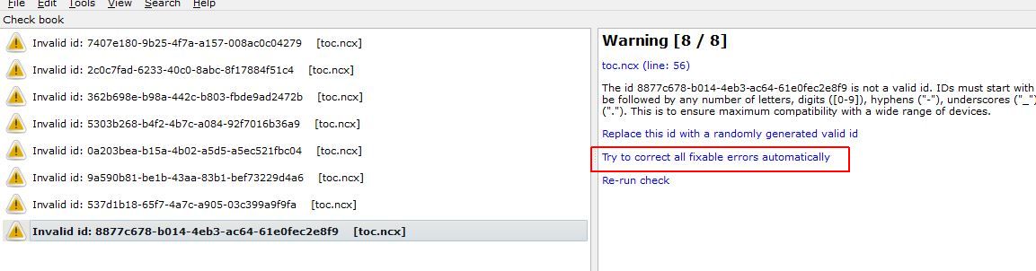

Posts: 22,956
Karma: 34252880
Calibre's Check book produces a list of errors before it offers the choice to automatically fix all errors
