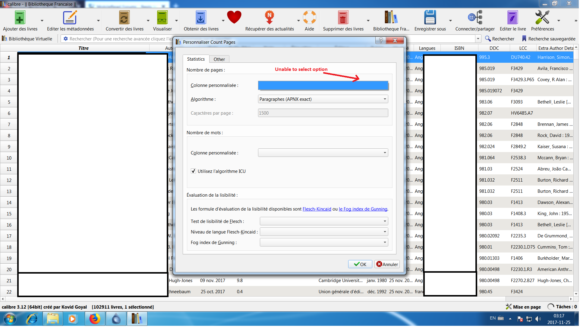

Hi,
I was looking for your plugin, and i installed it on Calibre. But unfortunatly i'm not able to select a custom column from the menu and i can't choose any option. There is a blue rectangle and it's blank.
Please can someone explain to me how to solve this? (Edited : someone on the forum talk about numeric column). Can anybody tell me how to modify my library to do it?
I don't know what i'm doing wrong...
thanks.
Here a picture of that problem :

Old 11-25-2017, 03:49 AM   #1138
davidfor
Posts: 24,905
Karma: 47303826
Location: Sydney, Australia
The configuration dialog should show all custom columns that could be used for the page and word counts. So, it should be showing all custom columns that are integers. Do you have any of these?
Old 11-25-2017, 03:55 AM   #1139
steris8
steris8 began at the beginning.
Posts: 6
Join Date: Nov 2017
Ok... i found that when i use the button down for adding column... i have all the options. But not when i click on the side icons.
i think all is ok...
