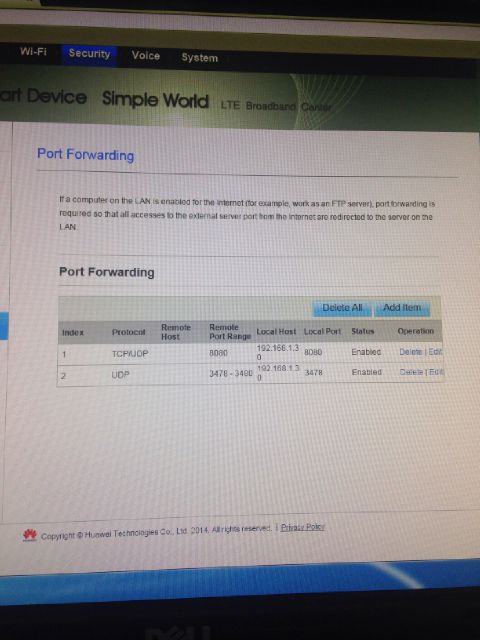

How to set the port forwarding
The ip address of my content server is 192.168.1.30; port:8080. For the port forwarding I have protocol:; remote host; remote port range ; local host; local port. So please tell me what to do
Try: Protocol tcp/udp if possible, otherwise tcp. Remote host is blank. Remote Port Range is 8080, local host is 192.168.1.30, local port is 8080.
Good luck.
