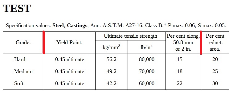

Today I had some issues on creating a table which used rowspan. The result in the calibre previewer did not show some borders, nor when viewing the epub with calibre. Only after a long time of trying and trying, it turned out that the resulting epub page was showing correct on my e-reader itself, but just not on the calibre (pre)viewer.
To test I used the following (test) html page:

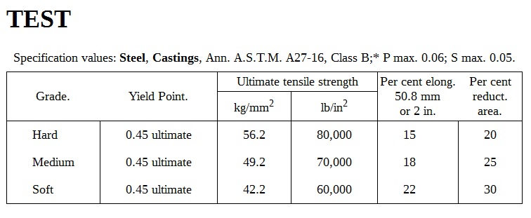

The code above produced the following result in the calibre previewer (picture1), in which borders where missing (indicated by red in picture2). These missing borders are showing on my e-readers.
Is this a known anomaly of the calibre (pre)viewer?

It is a bug in the version of webkit shipped with Qt. Using a newer version of webkit fixes it, but it will be some time before calibre ships with a newer version of webkit. You can use the new browser viewer in the mentime which will not have this bug.
