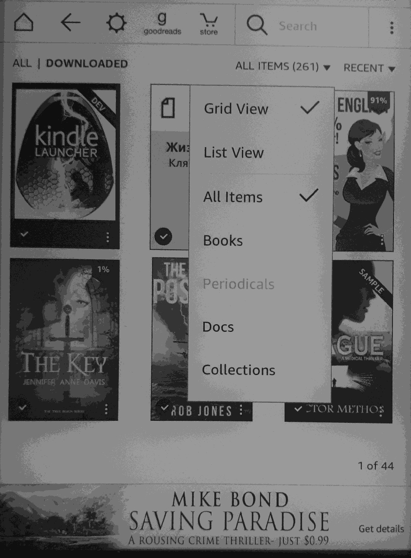

1. Change the view from "Book" to "All item" or "Docs" (See the picture below). Your documents are still not there?
2. If you open the mounted folder [KINDLE]/documents from PC in it there are your files?
