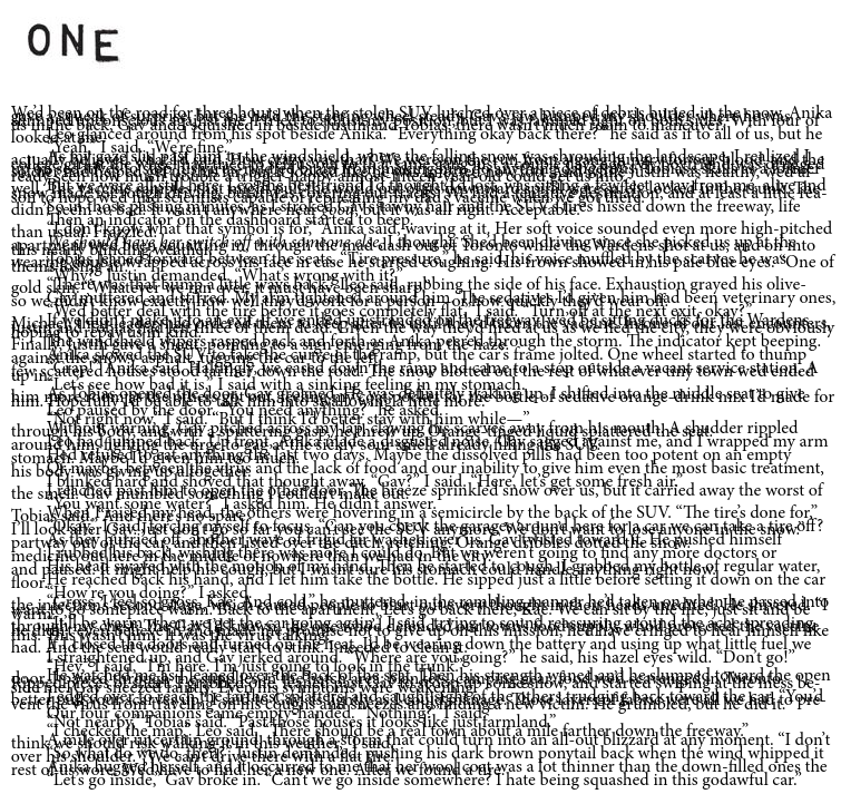

Originally Posted by icallaci View Post
I realize this is a long shot, but thought I'd ask anyway: the Quality Check plugin has identified ~500 epubs in my library where the CSS contains "line-height: 1;" or "line-height: 1em;". I'd like to change all of these to "line-height: 0;" but the thought of editing 500+ files one at a time is daunting.
Removing the line-height might work but setting it to 0? That is going to give rather interesting results -- the line-height is multiplied by the font size to generate the line height.
I've attached two screen shots, one from ADE 4.5 on my PC and the other from my KA1. Just a titch unreadable, IMNSHO.
ID:	158170   Click image for larger version
I always remove any line-height properties except for initial capitals and superscripts/subscripts, which I had been setting to 1. I've found that 0 works better for those. If I remove line-height from paragraph styles, I don't run into the problem you show in your images at all. So the only line-height properties remaining in my epubs are for <span> or <sup>/<sub> and 0 works great for those.
The following is what I use for sub/superscripts without having extra space added between lines. I put line-height: 1.2; in the body class since I find it the easiest on my eyes. For chapter headings and other text where I want the white space, I use various margins. For initial/dropcaps, I have several styles to choose from depending on what appearance I want using various margin values to align the capital with the text.
