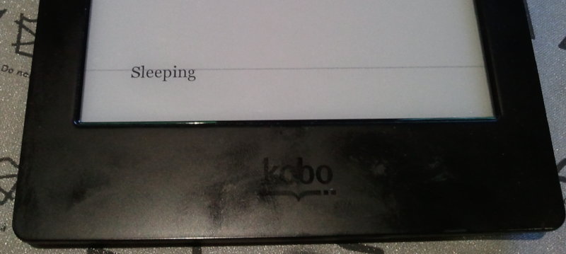

The scanline would not appear in the .example but in a new file screensaver.cfg - if it's not already in there (in this case you might edit and delete). Also on screen, like this. (Line appears short while after Sleeping appears.)
I am using KA1-4.2.8283-ScreenSaver-experiment2.zip
Yes, me too... I even checked the checksums, I am using the very same script and version I uploaded here.
I guess I'll just have to add a full blown debuglog but I just didn't get around to it, sorry

Works!
Hi,
I haven't changed anything, but it just started working all of a sudden. I saw the line through "Sleeping" all of a sudden, then did a power off and then it started working.
Somehow it took a while to configure itself. Very cool, thanks for the help!
