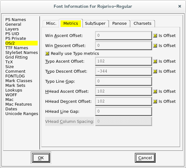

* Changed HHead ascent/descent offset to 224/284. This is an attempt to work around a bug in the Kobo KePub reader, where page breaks leave the top part of the glyph on the previous page when the line spacing is narrow.
Edit: Updated to v3.2, which tries to find a medium between the line split problem which appears in KePubs at narrow line spacings, and the clip problem that appears at larger font sizes.

I've added v3.1 to the above post. It turns out that trying to avoid one KePub problem just causes another.
* v3 is probably better for those who read KePubs with very narrow line spacing.
* v3.1 is probably better for those who read KePubs with a large font size.
Either version is fine for reading ePubs.
Edit: The only difference between v3 and v3.1 is the HHead ascent/descent offsets. If you want to play with them in fontforge you might be able to find a setting that works better for you. Increasing both offsets improves the split problem and worsens the clip problem, decreasing both offsets does the opposite.
