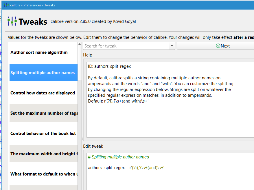

So this should work, then, to get around Calibre's turning "with" in the author field into an "&"?
add_to_replace_metadata:
author=>Old Man with a Pen=>Old Man with-a Pen
dwraith0877 is offline   Reply With Quote
Old 05-19-2017, 10:53 PM   #2102
JimmXinu
Plugin Developer
JimmXinu's Avatar
Posts: 7,717
Karma: 5010863
Location: Midwest USA
Yes. You can also universally change it so Calibre doesn't split authors on 'with' by changing the authors_split_regex tweak in Calibre Preferences. It's a change I use myself. See attached.
