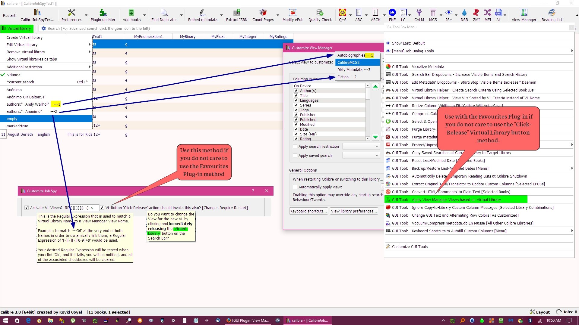

Originally Posted by Tanjamuse View Post
I have looked at Job Spy but find it a very confusing plugin to work with.
Tanjamuse:
See the attached. That should un-confuse you, since that particular GUI Tool is as easy as pie to use.
DaltonST
I've looked at it and tried it and still find it very confusing.
Tanjamuse:
I surmise that your mappings from "VLs to VM Views" are "one to many", which that particular JS+ GUI Tool does not support. It supports "one to one" and "many to one".
VLs are "specific", and Views are "generic", so "one to one" and "many to one" mappings make sense, and can easily be handled by JS+. The JS+ GUI Tool is triggered by a Calibre action, not a VM action, because JS+ is not VM. You need a VM trigger.
DaltonST

JimmXinu:
No worries.
The JS+ GUI Tool to change the View based on VL is invoked explicitly by the user in either of two ways, both of which are shown in the attached image in my post of yesterday:
[1] The user clicks a Favourites shortcut to the GUI Tool's menu item; or,
[2] The user clicks and immediately releases the Calibre GUI "Virtual Library" button. The resulting Qt "released" event for that pushbutton is connected to the same function as the Favourites shortcut, which is also the same function as if the GUI Tool action were invoked directly from the JS+ Menu itself.
Obviously, the user must also have activated that entire GUI Tool by clicking its checkbox to do so in JS+ customization. Nothing happens if they choose to not use it.
So, the user selects the VL, and then intentionally causes the JS+ GUI Tool to activate the matching VM View by a click or a click-and-release, depending on what they clicked.
That is the opposite of what Tanjamuse is describing. She wants to select the VM View, and have VM activate the matching VL automatically once the selected VM View becomes active. That provides her a "one to many" mapping capability of VL to View that she needs. JS+ only does "many to one".
From what I see, the VM plug-in just needs a new "Apply Virtual Library" checkbox and dropdown à la "Apply Saved Search", and then apply that VL whenever a VM View is chosen.
Tanjamuse can then map as many Views as she pleases to the identical VL.
In summary, the described new VM functionality in no way interferes or collides with the JS+ functionality. Both can be used simultaneously if the user can remember what-is-what. It really depends on whether their VLs are "specific" and their Views are "generic", or vice-versa. JS+ implicitly assumes the former, and VM's new functionality would implicitly assume the latter,
DaltonST
