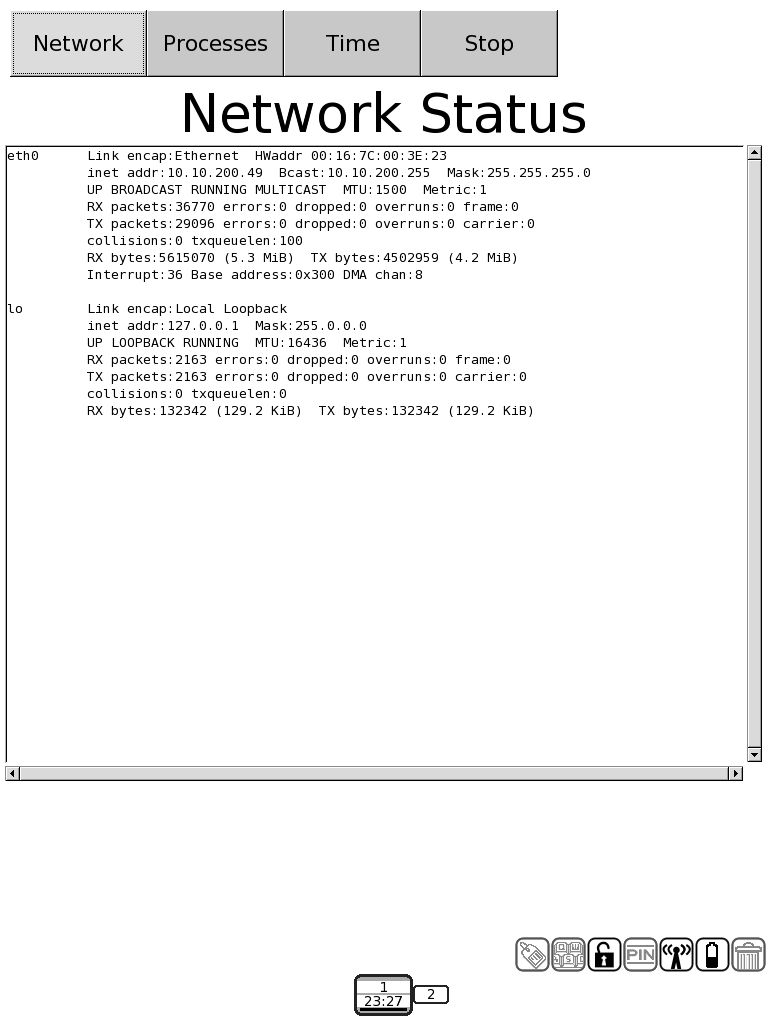

Hi All,
Here is a first release to play with (with a working demo). Unpack the tgz on your memory card, an click the icon
The following will happen (hopefully):
  • The first time Lua and the UIP (gui toolkit) package will be installed (in /usr/local, eating about 1.4 MB). If you have installed my earlier Lua package: it will be upgraded neatly!
  • The run.sh script starts the demo script (hello.wlua) with Lua (/usr/local/bin/lua). The screen refresh is handled by a small xepdmgr like program called xx.
I know the led blinks: I'll fix that later...
The sources and the build script for the Lua-Iliad can be found here:https://dev.mobileread.com/svn/luailiad/trunk/
xx (the refresh) can be found here: https://dev.mobileread.com/trac/luailiad/wiki/refresh
Look at the script, play with it, and let me know what you think...
Have fun,
Hansel.

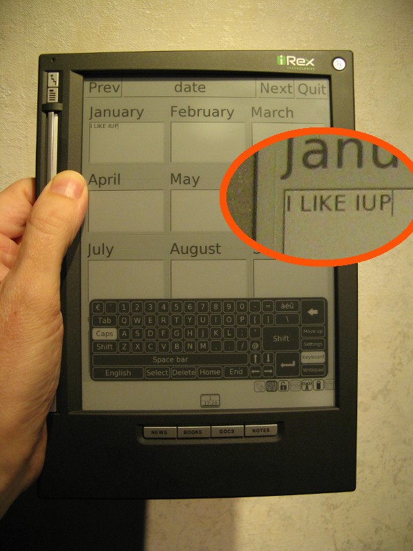

Progress report...
Update: UIP looks great. I'm still struggling with some widgets (images on buttons and texts on radio buttons do not show on the Iliad). Apart from that it's quite easy to make a nice gui. Selecting fonts and font sizes works. Hand written text from the virtual keyboard gets in the text fields)
As you may guest form the picture, I started a small calendar app...
To be continued...
PS: I use UIP from Lua, but it can also be called form C/C++
