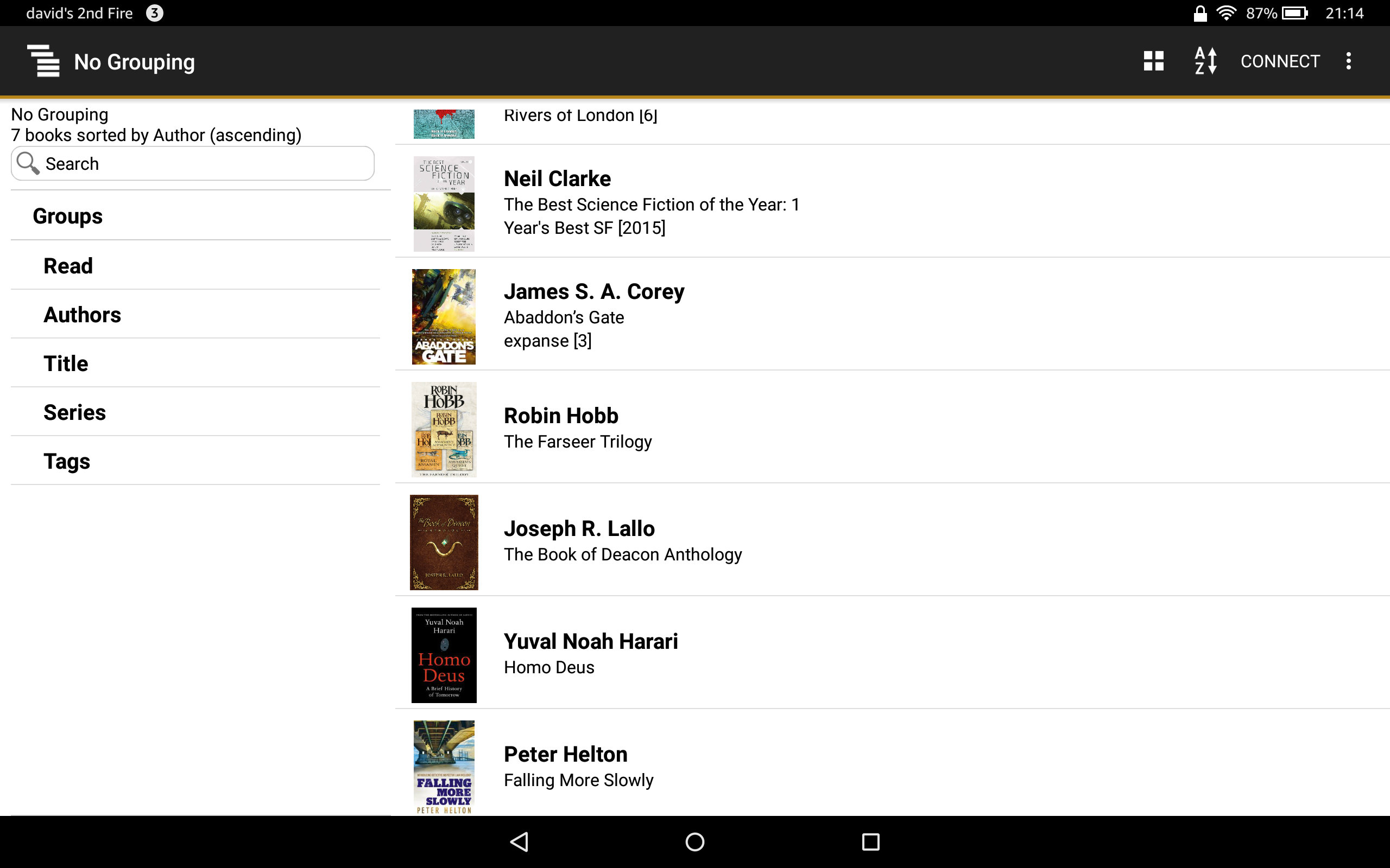

Seven books on device. Grouping by author confirms that my author surname groups are
one a
two c
three h
one l
to the right, where I set display to a z by author, I expect an a z ordering of cover thumbnails
But That thumbnail list places the l between two of the h and it places ho before ha.
So I get this order Corey, hobb, lallo , harari, helton
All other sorts e.g. by title seem well behaved.
I have tried added, removed some of the books and exited restarted cc. The sort order is consistently wrong. The same wrong order is applied if I ask to see the seven books on a shelf.
I prefer to e-mail screen shots rather than type full author names. Is there a known bug. Is a z a full sort or only first letter. I.e.should ha precede ho or is that random.

Get the Calibre plugin: Quality Check
Run the section that checks Author sort. I suspect that will find a lot of red (in the MDE window)
Select all those: Tap E (bulk mode MDE), and tick the recalculate Author sort: OK

As theducks points out the sort works great. It is most likely your metadata in calibre's Author sort field that is in error. Following theducks advice should get your "Author sort" metadata field consistent with the Author field you see in the listing.
Once you correct the data in calibre simply connecting your device via CC as a wireless device will correct the metadata in CC on your device.

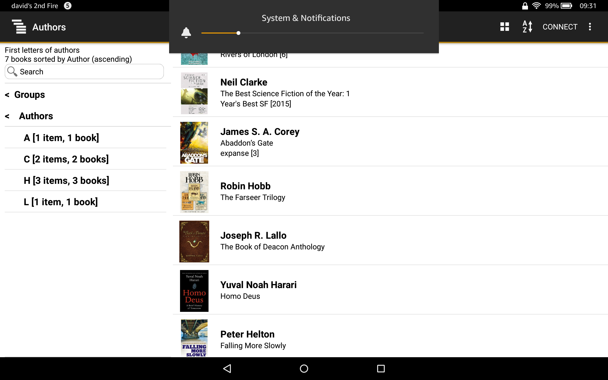

what i saw is the previous screenshot. on that screen I can optionally turn on author grouping by 1st name, that changes the left side of the screen but the 7 thumbnails & book info entries on the right are unaffected.
I have done that as a new attachment.
From the feedback supplied hereI am confident that author grouping on letters works by author surname somehow, but the a-z of books on device is using the ( hidden) author srot supplied by calibre.
NB I always use connect to content server for transfers , not connect as wireless - dunno if that is a factor.
in this new screen shot - he author groupings shows 3 x H, 1 x L, 0 x P
but we now know that Peter Helton has an (wrong) author sort of Peter Helton, so it is sorted as a P in the thumbnails column, below Lallo, but counted as an H in the author grouping
so the screen in its entirety appears to contradict itself. it maybe only happens with content server, not with wireless device ?
does that make sense now ?

Author_Sort is used to SORT
Author_Sort is in the Metadata of the book , whichever CC method you transfer with

Here is what CC does, with some references to what calibre does as explanation:
  • CC never uses metadata from inside a book. Instead it uses metadata from calibre's database. The only exception is if scan for new books is enabled then at the beginning of a connect as wireless device CC will build a temporary book record from the metadata in the book.
  • When you sort the book list by author, CC uses author_sort from the calibre db book record. This ensures that books with multiple authors sort consistently.
  • The grouping drawer is sorted using the individual sort values for authors. You see these values in calibre's Manage Authors dialog. Note: if in calibre you change the sort value for an author then calibre will recompute the author sort for all books with that author.
  • The first letters shown in the grouping drawer are the first letter of the individual author sort values.
  • In all cases, sorting is done using "International Components for Unicode" sorting rules. This matters because sort order is language specific, not alphabet specific.
From the above we see that it is possible that the grouping drawer will sort differently from the book list. This happens if the individual author sort value differs from the author_sort value for a book. If this mismatch occurs then calibre makes the author_sort line in edit metadata red. It is also possible that both the book list and grouping drawer can sort "incorrectly" but consistent with each other. This happens when the author_sort values are all green but the values are not correct.
It is generally not a good idea to change the author_sort for a book but not change it for the individual author. Said another way, it is generally not a good idea to have red author_sort values in a book.
It is worth noting that similar processing is used for titles (title_sort) and series. One difference: because a book cannot have multiple titles or series there is no notion of "individual" vs "book". Another difference: series_sort is calculated by calibre and passed to CC. Calibre does not provide a UI to change this value.
