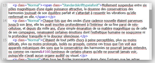

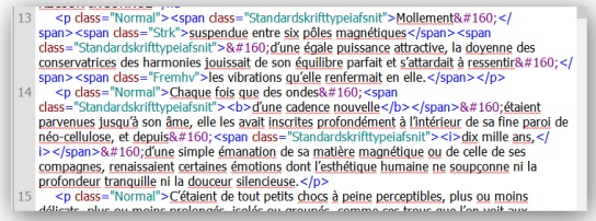

I just couldn't resist - so here are my findings:
I think I've found the explanation. Whenever you apply some formatting - be it by keyboard shortcuts, setting a style or by a macro/vba program/whatever - Word (2013/2016, I'm on 2016) internally resets the style to the "DefaultParagraphFont" or in french, "Policepardfaut" style, before applying the new style. This is not visible to the naked eye, but you will see it when exporting to .odf and importing in Sigil (you can see something similar when exporting to unfiltered .htm and even in the internal .xml, if you feel brave enough to unzip a .docx-file and analyse the contents).
The DefaultParagraphFont (which is not the msoNormal-style as I asumed in a previous post) is special, and does not behave like any other (ordinary) style. It's normally hidden (in 2013/2016 anyway), and it can't be deleted. It's used for resetting text more or less to the bare necessities used in the actual paragraph.
There's an article concerning the DefaultParagraphFont here:
http://word.mvps.org/faqs/customization/DefParaFont.htm
with a link to an article about customizing the standard settings for the various Word versions up to and including 2016.
I enclose a couple of screenshots (please substitute "Policepardfaut"/"Defaultparagraphfont" for "Standardskrifttypeiafsnit". The first one is the unedited word file (I've used Roger Farney: Les Anekphantes from "Ebooks libres et gratuits"), exported to odt and imported in Sigil using the ODTImport 0.3.1 plugin by Doitsu. In shot nr. 2 I've done a little editing in the original word document before exporting (setting bold and italics using a style in the first paragraph and using keyboard shortcuts in the next). The third is an unfiltered htm-export from the same Word-document used as source for no. 2 (- just for the sake of illustration)
So it seems you can't avoid the "Policepardefault" in the Word-exports to ODT (I tried importing some of the odt-files from "Ebooks libres et gratuits", and the "Policepardfaut" are also found in some of them, as is also seen in screenshot no. 1) The best solution - since the source of the problem isn't your template or the VBA-macro, but Word itself - is probably making a saved regex in Sigil and run it on all html-files before doing anything else.
Regards,

Congratulations for a successful inquiry and lots of thanks for explaining at last how "Policepardfaut" came to infest silently the odt files in their xml innards before blooming later in the EPUB as multiple "Policepardfaut" spans.
Of course I already use a saved search to discard these pesky spans. This is easy, but finding the reason was quite tricky.
BTW, I also use ODTImport and people at ELG will be happy to see that there is at least a Danish reader.Just hope you are not alone.
Conclusion: A warning to odt users of Word 2013
So, it seems this thread finally reached a successful conclusion as all the questions which have been asked for have found, if not a perfect solution, at least an explanation and a workaround.
odt users of Word 2013 (2016?), should be ready to correct two Word induced defects appearing on their EPUB after conversion of their odt file:
1. - you'll have to correct the relative width of images and (maybe) suppress an empty paragraph
2. - you'll have to use a regex to suppress the useless and empty "Policepardfaut" spans.
