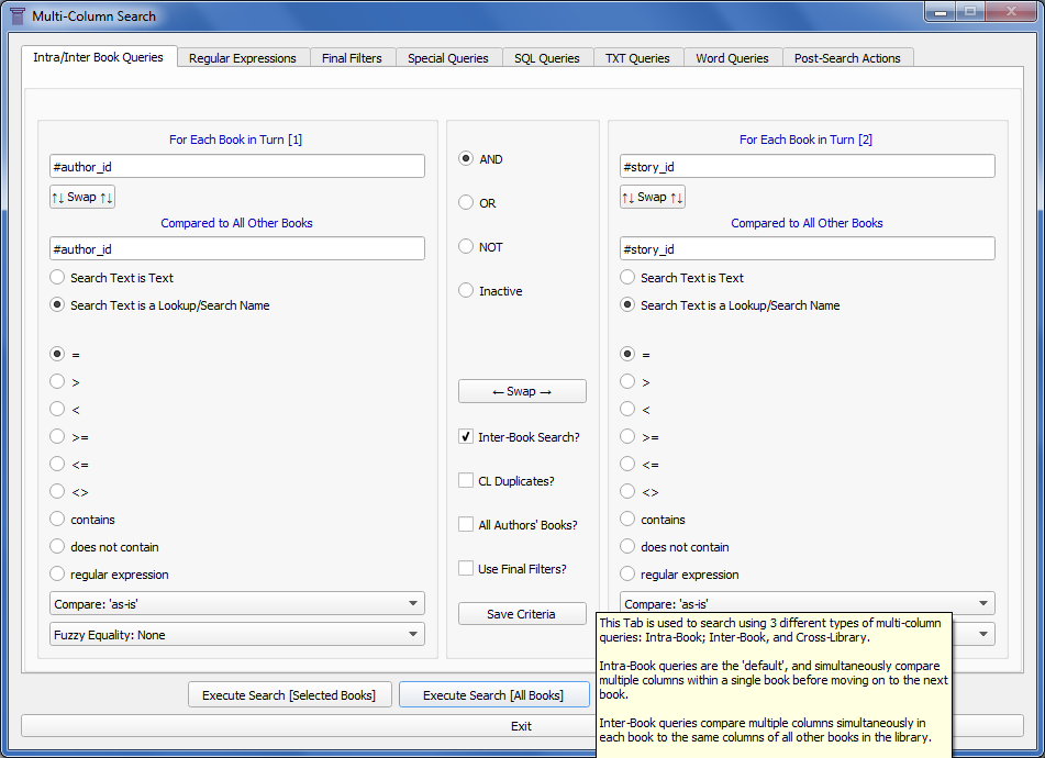

2 types of Cross-Library Queries
Originally Posted by Tanjamuse View Post
Is there any way I can set this search criteria as standard instead of author and title?
There are 2 types of Cross-Library Queries: CL Intra-Book and CL Duplicates. See the attached image.
MCS will automatically validate your parameters and tell you of any parameter errors when you click the "Save Criteria" button.
DaltonST

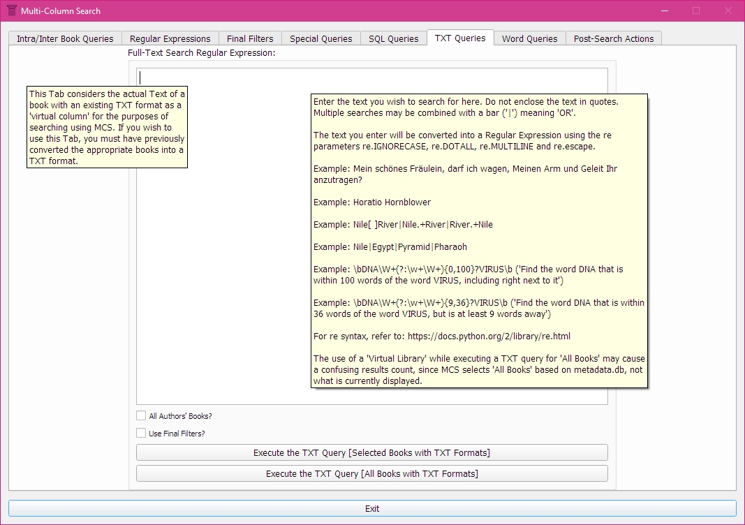

I'm trying to figure out how to use this to do a full text search, and am apparently doing something incorrectly. Could I be walked thru the process of doing this, please?

The ToolTips are quite detailed and explain everything. I have attached them below.

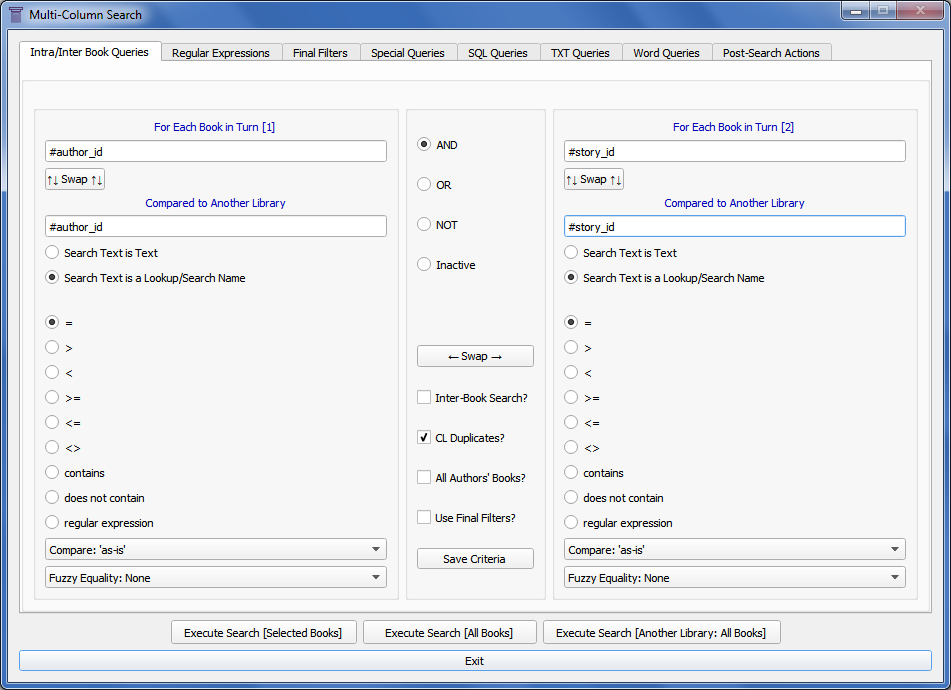

How do I use the search in this screenshot in a single library instead of searching for duplicates in 2 libraries?
Name:	Skærmbillede 2017-09-08 10.58.13.png
Old 09-08-2017, 11:32 AM   #191
DaltonST
Deviser
DaltonST's Avatar
Posts: 2,265
Karma: 2090983
Join Date: Aug 2013
Location: Texas
[1] Uncheck the "CL Duplicates" checkbox. The screen will reconfigure itself for an "Intra-Book Search".
[2] If you want to do an "Inter-Book Search", check the "Inter-Book Search" checkbox, and the screen will reconfigure itself for an "Inter-Book Search".
[3] For example scenarios, see the many images attached to the Original Post of this thread.
[4] Hover your mouse over each area and widget in the screen to read their respective ToolTips.
[5] Remember to "Save Parameters", which will also validate your settings and issue any error messages.
DaltonST
Old 09-08-2017, 05:43 PM   #192
Tanjamuse
Posts: 1,327
Karma: 5306
Join Date: Jan 2014
I Think I've done as you suggested (see attached image) but I get an error when I select: Execute Search [all books].
The error is:
calibre, version 3.6.0
ERROR: MCS: Cross-Library Duplicates Searches are never for 'All Books'.  Use 'Another Library [All Books]' instead.                                                                Execution Canceled.
Name:	Skærmbillede 2017-09-08 22.41.42.png
Old 09-08-2017, 06:10 PM   #193
DaltonST
Deviser
DaltonST's Avatar
Posts: 2,265
Karma: 2090983
Join Date: Aug 2013
Location: Texas
You need to Save your criteria before clicking Execute. It thinks you still have "CL Duplicates" checked. As a last resort, Save, Exit, then rerun MCS. Your saved criteria will appear.
