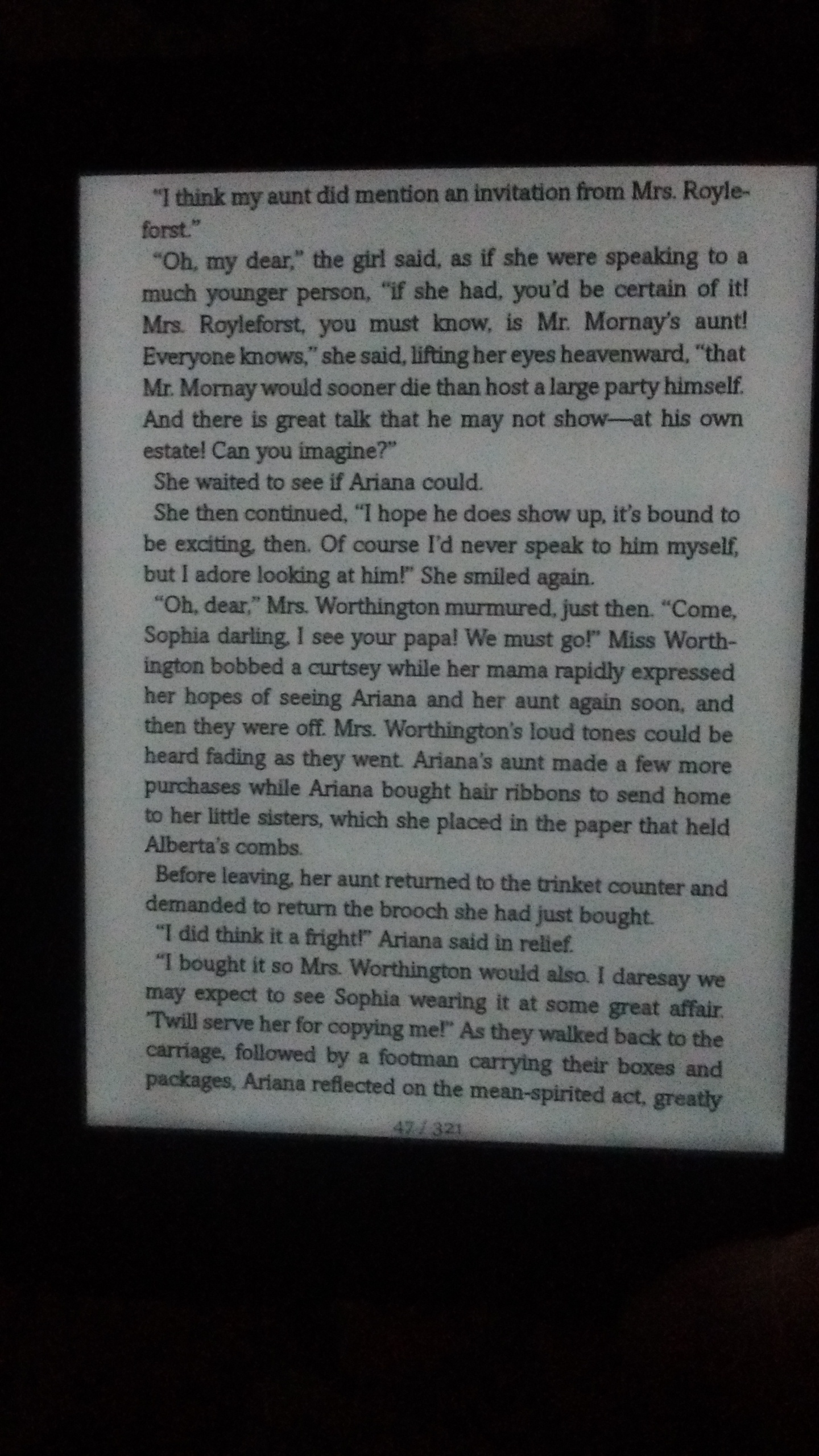

Thanks, I will try that. As you can see in the screenshot attached. The margins are not wide enough. The slider is all the way to the right. I need the text to be smooshed just a little more for lack of a better description.
Are you talking about the left and right margins? They look huge to me, but if you really want them larger then disabling the `Custom left & right margins patch` should make them about twice the size.
If you are talking about the top and bottom margins, then you need to look at the `ePub fixed/adjustable top/bottom margins` or `ePub fixed top/bottom margins` patches.
I have a possible solution to your problem. Part of the problem is the settings in Kobo's hyphenation dictionary. It is set so you only get a hyphen with 5 characters or more. The one I've linked below is set to 2 or more. So you may find more hyphens for better spacing. This is the hyphenation dictionary I use (So I know it works with every firmware) and it works much much better than Kobo's. All you do is unzip and drop KoboRoot.tgz into the .kobo directory and when you eject, it will install. You have to do this after you install each new firmware. I don't know aif it can be installed before the patches. So I patch and then install the hyphenation dictionary.
https://www.mobileread.com/forums/sh...d.php?t=252405
The one you want is JSWolfHyphenUS-EN.zip. If you are not using it and you do use it, please let me know how it goes for you. Thanks.
Yes left and right. It sounds like disabling the custom margin patch is just what I want. Thanks so much! I get many like narrow margins but when you switch from phone to reader often it easier for me to just use wide margins so I don't get eye strain.
