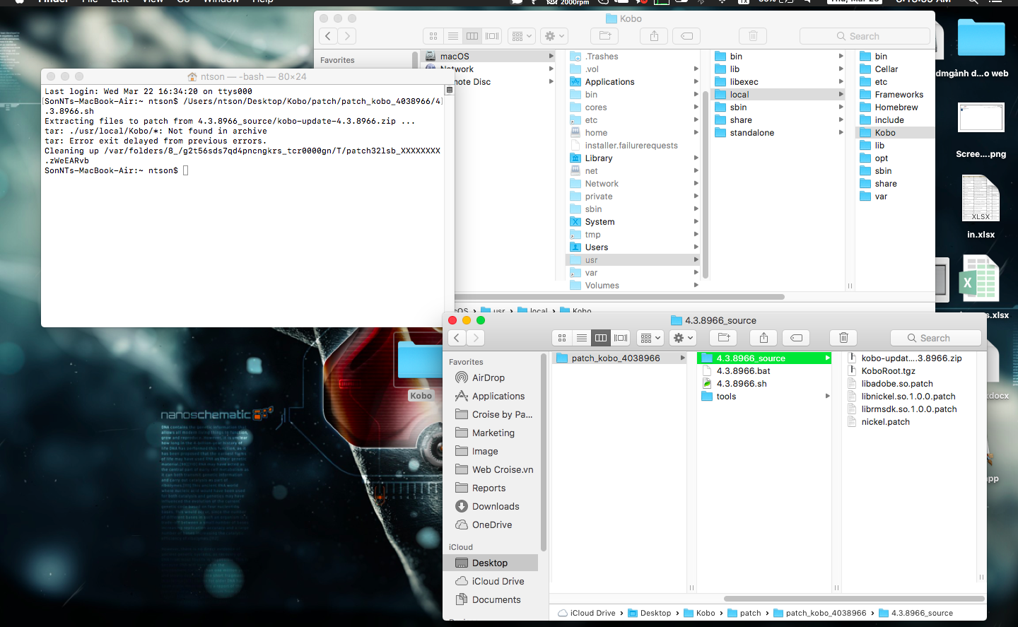

ntson
ntson began at the beginning.
Posts: 15
Join Date: Mar 2017
Device: Kobo Glo HD
From your error messages, it probably means that the kobo-update-4.3.8966.zip file is not in the 4.3.8966_source directory. See step 2. of the instructions in the first post.
Edit: Itcould also mean that there is a file named kobo-update-4.3.8966.zip but it is the wrong file or didn't download properly. In that case try removing it and downloading again.
i'm cope file KoboRoot.tgz from folder firmware i extracted to 4.3.8966_source directory to fix error: filename not matched: KoboRoot.tgz
and now, it's still error. How can I fix it?
pls see my attachments.
Last login: Wed Mar 22 16:34:20 on ttys000
SonNTs-MacBook-Air:~ ntson$ /Users/ntson/Desktop/Kobo/patch/patch_kobo_4038966/4.3.8966.sh
Extracting files to patch from 4.3.8966_source/kobo-update-4.3.8966.zip ...
tar: ./usr/local/Kobo/*: Not found in archive
tar: Error exit delayed from previous errors.
Cleaning up /var/folders/8_/g2t56sds7qd4pncngkrs_tcr0000gn/T/patch32lsb_XXXXXXXX.zWeEARvb

Old 03-22-2017, 09:49 PM   #33
GeoffR
GeoffR's Avatar
Posts: 3,821
Karma: 19162882
Join Date: Nov 2012
Location: Te Riu-a-Māui
Device: Kobo Glo
Sorry, I don't understand what is happening. I can only suggest you delete everything and start again.
Don't extract the firmware, just leave it zipped. The patch script will extract the files it needs.

Old 03-22-2017, 11:09 PM   #35
GeoffR
GeoffR's Avatar
Posts: 3,821
Karma: 19162882
Join Date: Nov 2012
Device: Kobo Glo
Just as a check to see if everything is in place: before running ./4.3.8966.sh in step 4 of the instructions, try running the following command:
unzip -t 4.3.8966_source/kobo-update-4.3.8966.zip KoboRoot.tgz
If everything is okay it should give this result:
Archive:  4.3.8966_source/kobo-update-4.3.8966.zip
    testing: KoboRoot.tgz             OK
No errors detected in 4.3.8966_source/kobo-update-4.3.8966.zip for the 1 file tested.
(Edit: I'll incorporate this check into the sh script in the future, so it will give a more useful error message if the file is missing or damaged.)
