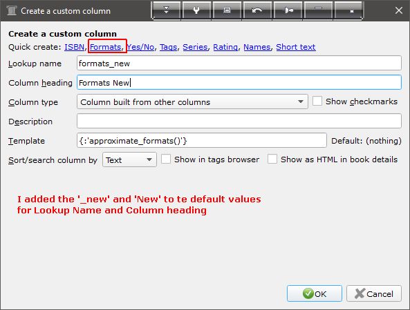

I would create a new column thus:
Assuming it's OK, delete the existing 'formats' column, and rename the new one as required.
The approximate_formats() template function reflects the formats whose existence is recorded in the database, before that function was added (quite some time back) displaying formats in the book list was cumbersome.
Might be worth running the Library maintenance->Check library function, the 3rd pass will report on discrepancies between what format files the database has recorded and what format files actually exist.
Attachment 155546
Great,..
- deleted the column and
- added the new one, as described and
- now indeed format is indicated in the Format New column 'as is',..
thanks for the advice!!
