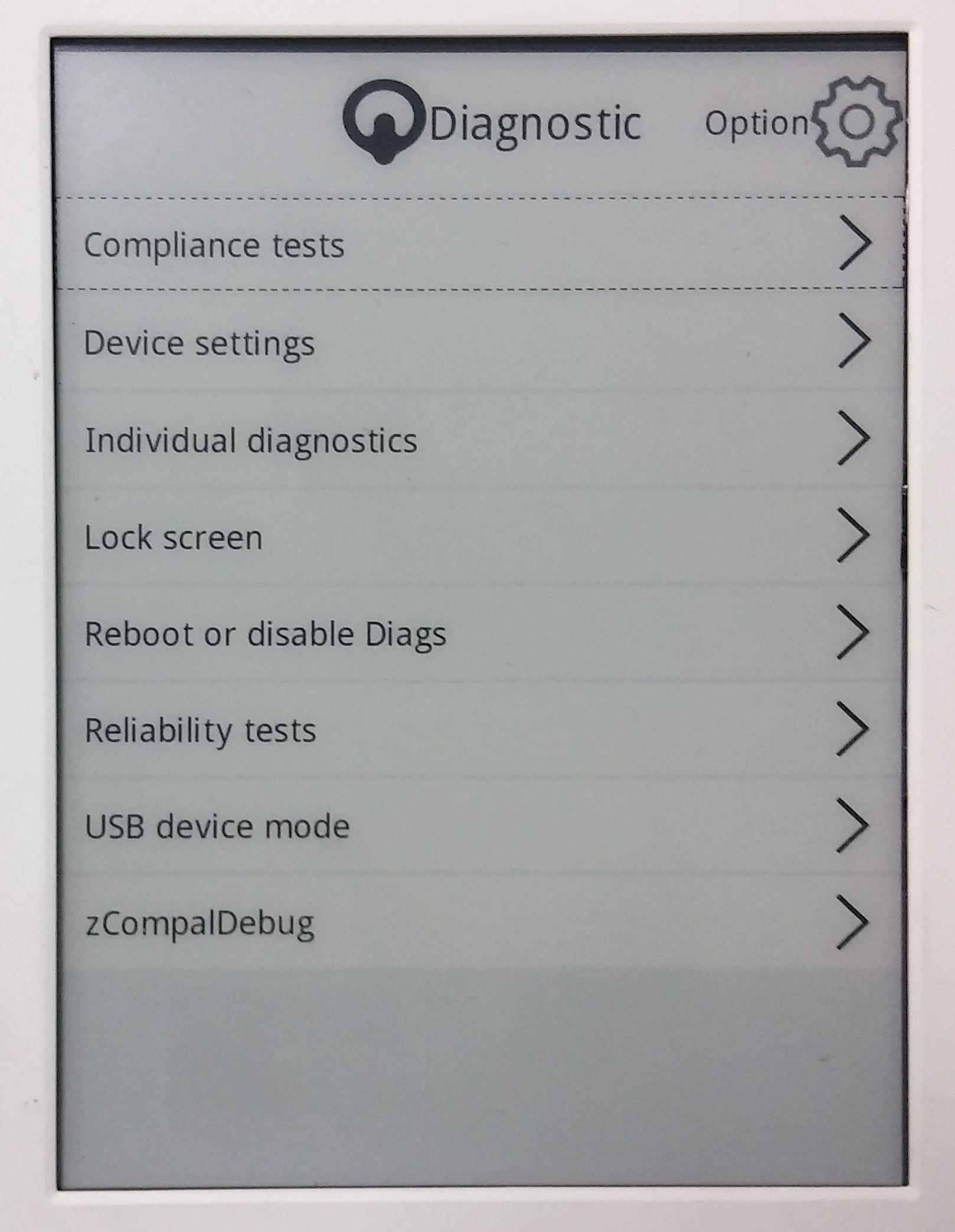

"Dear Friends" ???
You have never supplied or even responded to anyone answering your earlier posts, how can you claim to have any friends here?
Your last chance to cooperate:
Sure, use the menu entry named 'exit'.
If you don't see the diag menu, you had better give us more information, such as what you where doing that got you into diagnostics mode.
Also, what resources you have available (serial port connection, pc software, etc).
What firmware version is the KT3 diagnostic system you are having trouble with?
Have you read any of the things in the various de-bricking threads?
There is a 'sticky' with an index that leads to the de-bricking subject threads.
Sorry for the late reply.
The device is from my friend, she also cannot tell me what she did. However, now the diag mode is totally different what is before.
Lowantong is offline   Reply With Quote

Same choices, different graphics and the menu probably no longer works over the serial port.
Choose disable diags and reboot, same-same as other devices.
If she wasn't hacking the device, it needs to be in diags which means she should send it in for repair.
This isn't a free repair site.
