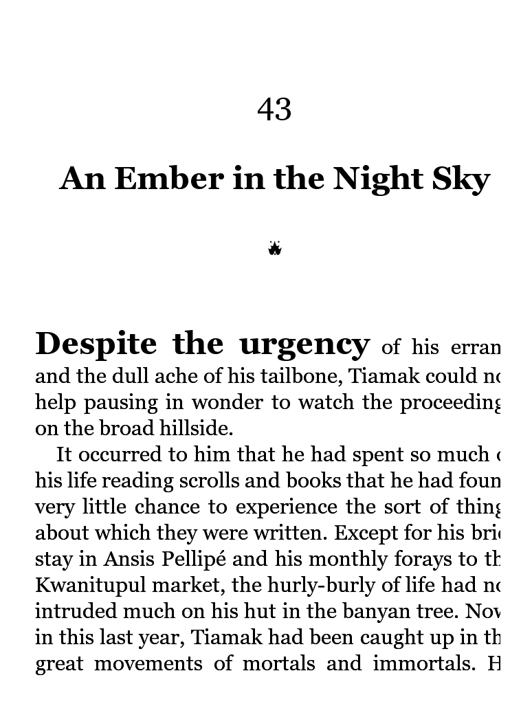

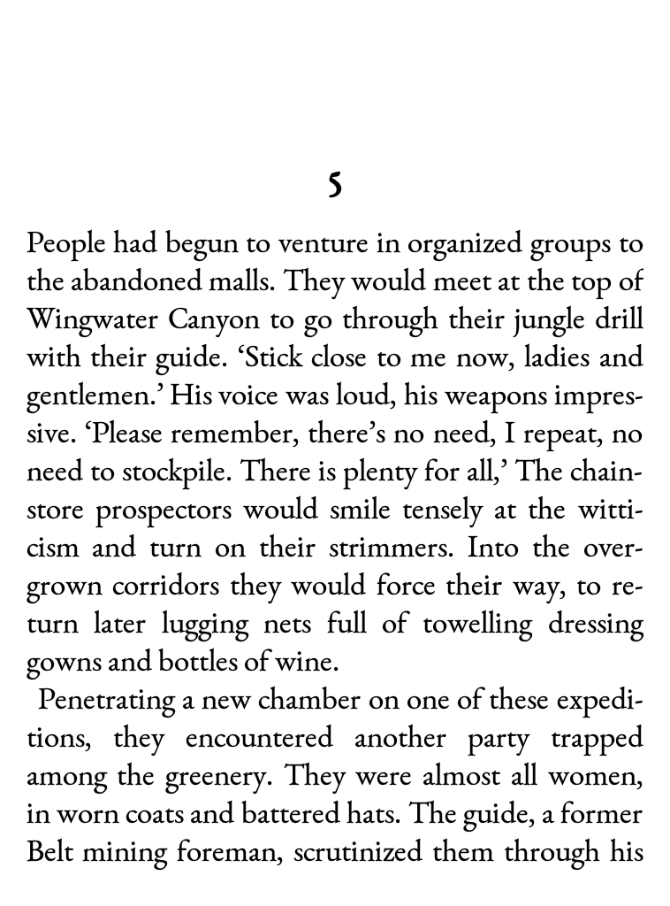

Originally Posted by GERGE View Post
Hey,
KePub fullScreenReading bugs seems to be fixed for Glo HD. I haven't encountered them since 4.x.x. Maybe they shouldn't be default anymore if other, newer devices are the same?
The bugs have not been fixed, the very first KePub I tested after installing 4.3.8842 was affected by the shift-to-the-right bug.
Edit: Here are screenshots from my Glo with 4.3.8842 without the `fix three full-screen bugs` patch, the first shows the shift-to-the-right bug that occurs when the book's body margin is non-zero (this book), the second shows the side bearing cut-off on the 'f' at the end of the second line (this book).
