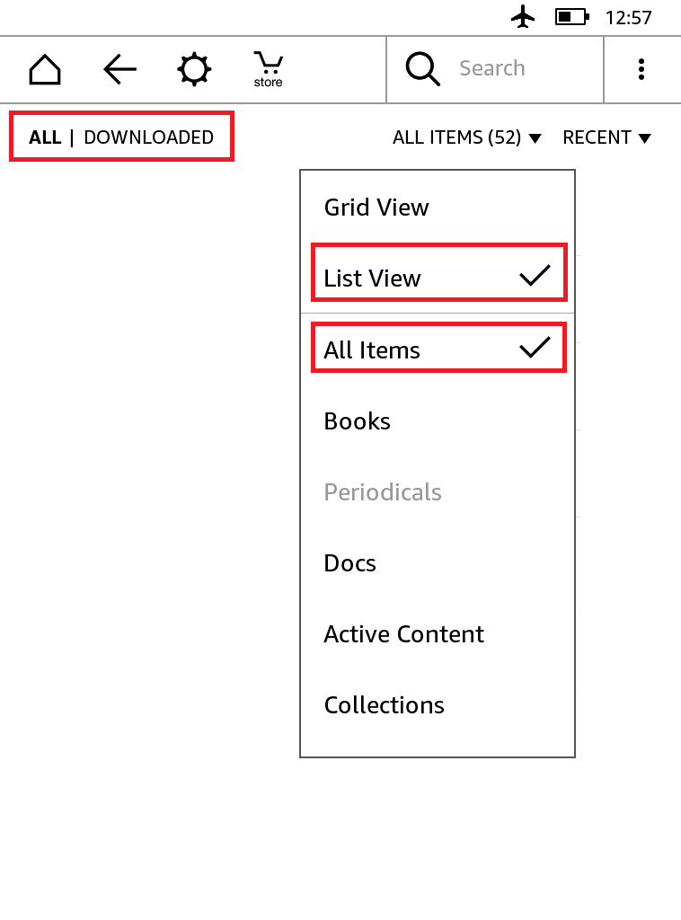

@HBH_AU: This might be a simple GUI settings problem. Go to the home screen and select:
List View ✓
All Items ✓
Then toggle between All and Downloaded. One of the two settings should enable the display of AZW3 files, provided they've been DeDRMed.
