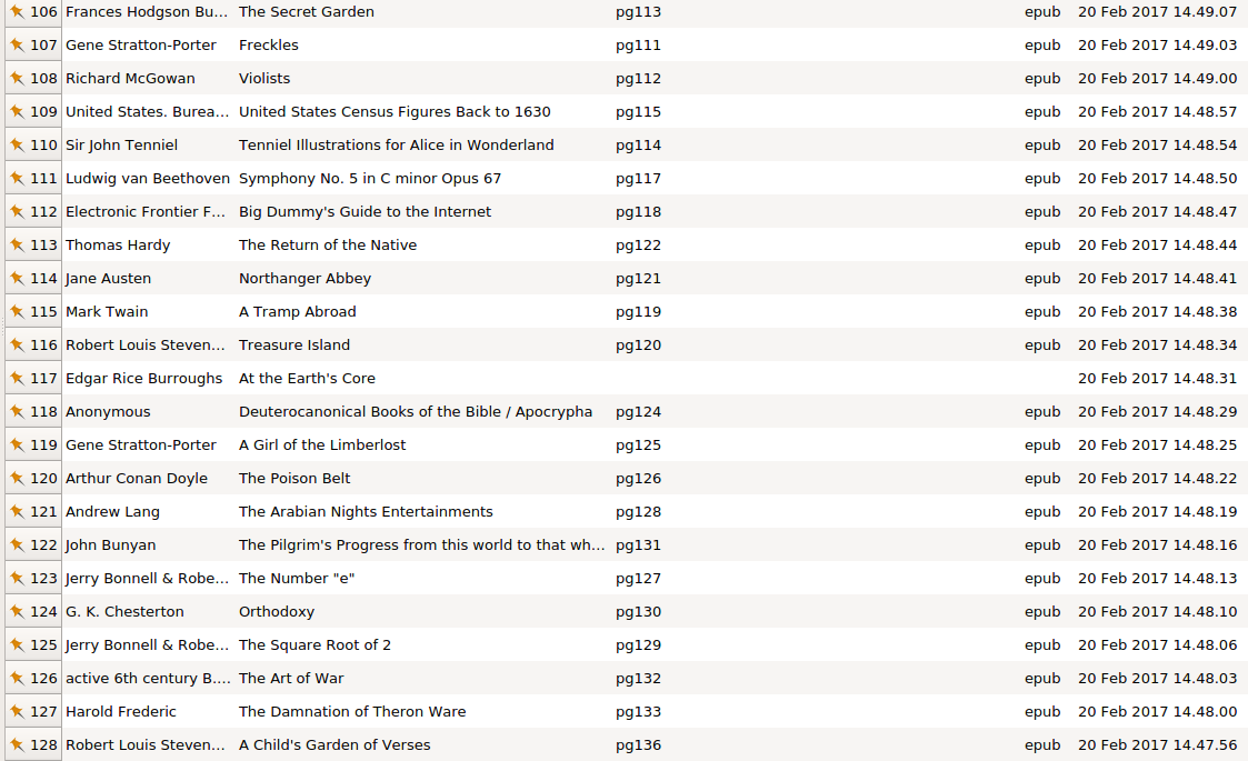

Thank you very much @terisa,
this looks much better now, nevertheless rarely the database seems to be under stress (BusyError: BusyError: database is locked).
Miscellaneous -> "Max. simultaneous conversion/new Download/plugin jobs" was set to 4.
DEBUG: 2382.7 File:  pg131.epub
DEBUG: 2382.7 Updating column  #fileext for book id:  711  with value:  epub
DEBUG: 2383.0 Updating column  #filename for book id:  711  with value:  pg131
Added The Pilgrim's Progress from this world to that which is to come / Delivered under the simi
litude of a dream, by John Bunyan to db in: 3.2
DEBUG: 2385.8 File:  pg128.epub
DEBUG: 2385.8 Updating column  #fileext for book id:  712  with value:  epub
DEBUG: 2386.1 Updating column  #filename for book id:  712  with value:  pg128
Added The Arabian Nights Entertainments to db in: 3.1
DEBUG: 2389.1 File:  pg126.epub
DEBUG: 2389.1 Updating column  #fileext for book id:  713  with value:  epub
DEBUG: 2389.4 Updating column  #filename for book id:  713  with value:  pg126
Added The Poison Belt to db in: 3.1
DEBUG: 2392.3 File:  pg125.epub
DEBUG: 2392.3 Updating column  #fileext for book id:  714  with value:  epub
DEBUG: 2392.5 Updating column  #filename for book id:  714  with value:  pg125
Added A Girl of the Limberlost to db in: 3.2
DEBUG: 2395.4 File:  pg124.epub
DEBUG: 2395.4 Updating column  #fileext for book id:  715  with value:  epub
DEBUG: 2395.7 Updating column  #filename for book id:  715  with value:  pg124
Added Deuterocanonical Books of the Bible / Apocrypha to db in: 3.1
Running file type plugin GetFileName failed with traceback:
  File "site-packages/calibre/customize/ui.py", line 209, in run_plugins_on_postadd
  File "calibre_plugins.getfilename.__init__", line 154, in postadd
  File "calibre_plugins.getfilename.config", line 110, in get_library_config
  File "site-packages/calibre/library/__init__.py", line 11, in db
  File "site-packages/calibre/db/legacy.py", line 76, in __init__
  File "site-packages/calibre/db/legacy.py", line 48, in create_backend
  File "site-packages/calibre/db/backend.py", line 402, in __init__
  File "site-packages/calibre/db/backend.py", line 576, in initialize_custom_columns
  File "site-packages/calibre/db/backend.py", line 822, in execute
  File "src/cursor.c", line 231, in resetcursor
Added At the Earth's Core to db in: 2.5
DEBUG: 2400.9 File:  pg120.epub
DEBUG: 2400.9 Updating column  #fileext for book id:  717  with value:  epub
DEBUG: 2401.3 Updating column  #filename for book id:  717  with value:  pg120
Added Treasure Island to db in: 3.2
DEBUG: 2404.4 File:  pg119.epub
DEBUG: 2404.4 Updating column  #fileext for book id:  718  with value:  epub
DEBUG: 2404.7 Updating column  #filename for book id:  718  with value:  pg119
Added A Tramp Abroad to db in: 3.3
DEBUG: 2407.6 File:  pg121.epub
DEBUG: 2407.6 Updating column  #fileext for book id:  719  with value:  epub
DEBUG: 2407.8 Updating column  #filename for book id:  719  with value:  pg121
Added Northanger Abbey to db in: 3.1
DEBUG: 2410.7 File:  pg122.epub
DEBUG: 2410.7 Updating column  #fileext for book id:  720  with value:  epub
DEBUG: 2411.1 Updating column  #filename for book id:  720  with value:  pg122
Added The Return of the Native to db in: 3.2
DEBUG: 2414.0 File:  pg118.epub
DEBUG: 2414.0 Updating column  #fileext for book id:  721  with value:  epub
DEBUG: 2414.3 Updating column  #filename for book id:  721  with value:  pg118
Added Big Dummy's Guide to the Internet to db in: 3.2
Added 832 books in 2736.0 seconds
This is 1 book each 3.2 seconds. I wouldn't expect this as stressful for the database. I do not additional access the database and I have only one instance of calibre running. I am using a hard drive for the calibre library with ext4 file system and a SSD as boot (and temporary) drive.

I cannot help in this, sorry. If there is a problem retrieving the configuration from the database, there is not a lot of things the plugin can do (aside of catching the exception in a most elegant way).
And the reason for stress? Sorry, I have no idea.

If some one is interested:
Miscellaneous -> "Max. simultaneous conversion/new Download/plugin jobs" was set to 1.
(Added 822 books in 2635.6 seconds)
Now I have 5 books failed getting file name and a "BusyError: database is locked".
The time to add a book was 2.8 seconds and higher if succeed and 2.3 to 2.6 seconds, if failed because the database is locked.
Failed:
<2.3 (0x)
2.3 (2x)
2.4 (1x)
2.5 (1x)
2.6 (1x)
Success:
2.7 (0x)
2.8 (1x)
2.9 (23x)
>= 3.0 (793x)
debuglog.7z.zip
AnselmD is offline   Reply With Quote

Yes, That's totally feasible, no problem with it. The other aspects, it's necessary a much deeper knowledge about calibre than I have. Perhaps something I'm doing in the plugin, but I don't know.
I was astonished, line 265 __init__.py
debug_print ("File: ", nom_fich)
was not reached. I thought the error happens at line 268ff (I have much lesser knowledge with calibre than you and I have a lack of knowledge in python too - so at these lines I think you do not have a chance to interact), but it happens
line 154:
library_config = cfg.get_library_config(db)
Isn't it possible, if the error occurs, to wait some time and to do it again?
