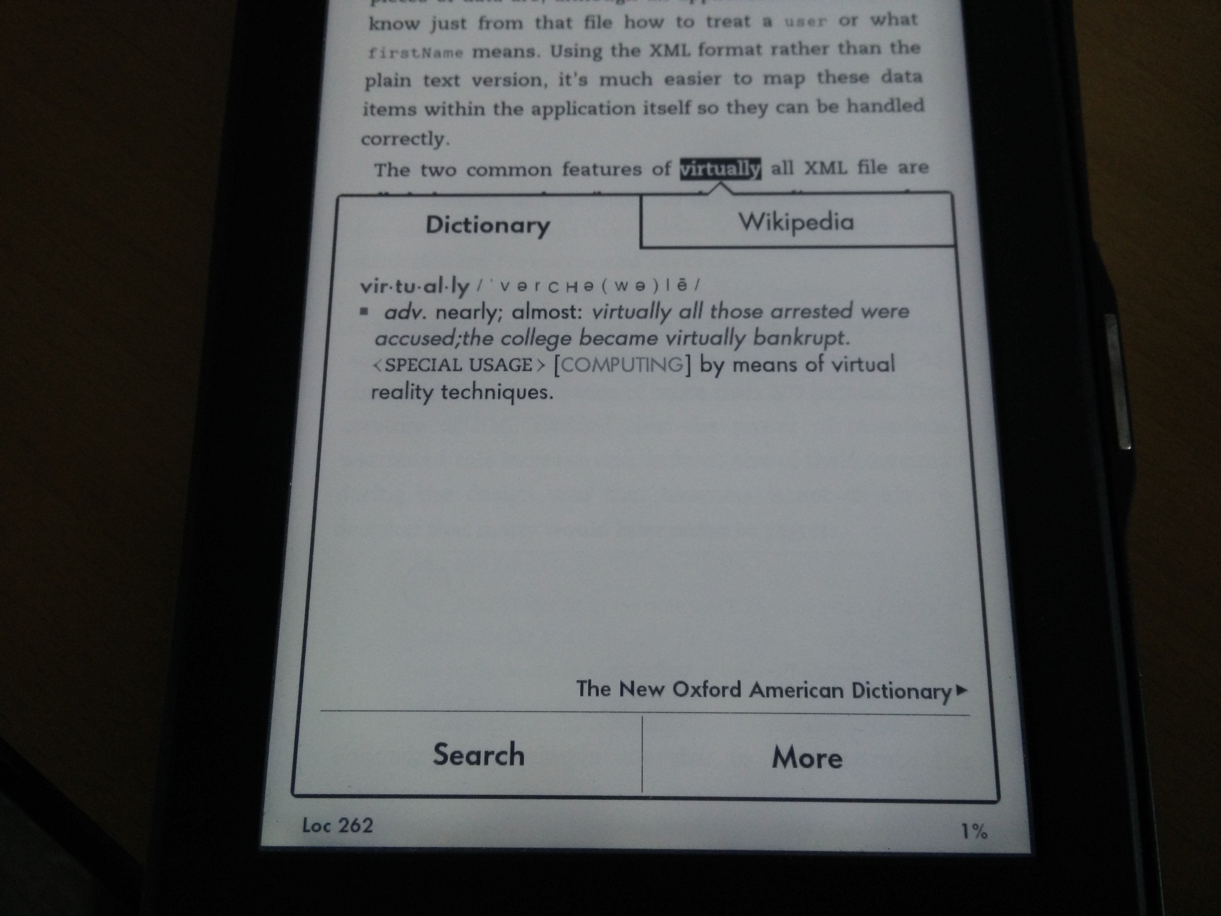

Old 10-10-2015, 11:02 AM   #93
MaCXyLo
MaCXyLo began at the beginning.
Posts: 7
Karma: 14
Join Date: Dec 2014
Device: KPW2
is it possible to add the menu items of the more options menu to the first select menu where the dictionary / wikipedia tab is shown?
i often translate stuff, so it would be much more comfortable if it's done with a single click.
greetz
