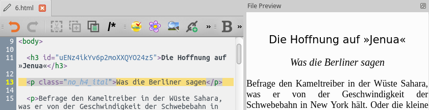

Very interessant, as usual! I read several times, still there are ambiguities. Understanding right it would be advisable to involve sigil for converting books. My OS is Linux Xubuntu, so Word (Microsoft) is not available for me.
In order to get my CSS clearer I name them somehow 'appropriately', e.g. <p class="no_h4_ital"> for something what looks like header, but doesn't function as one.
As a bonus the underlying tool (Mammoth converter) marks italicised text with <em> instead of <i> etc.
