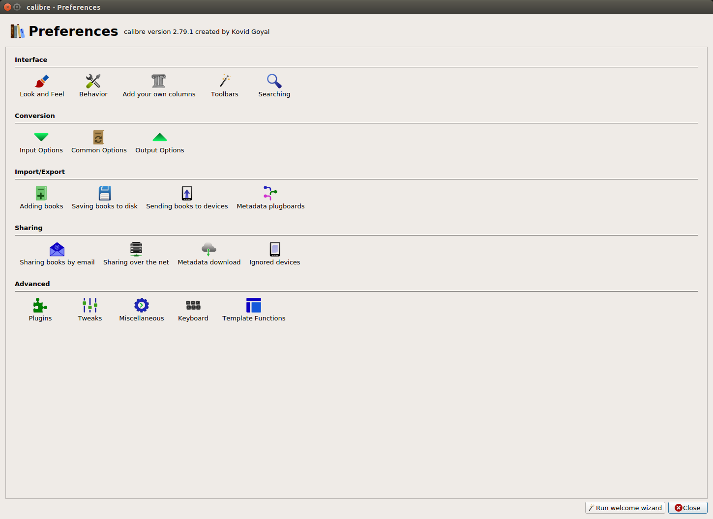

Old 02-17-2017, 09:14 AM   #132
AnselmD
AnselmD began at the beginning.
Posts: 105
Join Date: Oct 2013
In "theory" that is must be empty, but I did a "workaround": edit preferences and, without touching it, save it. I think it clears it.
If you have the log, you can send it to me and I look at it.
I would like to solve the 'Tratados' problem first, because it occupy 450,000 bytes in a line for each added book in the log - i can filter the log and take it away, before I send it to you.
I enter the main preferences dialogue I am not able to save anything, I am only allowed to "Run welcome wizard" or "Close". Close does not help. So I think you mean something different?! Click image for larger version

Old 02-17-2017, 10:26 AM   #133
Terisa de morgan
Terisa de morgan's Avatar
Posts: 6,773
Karma: 13151503
Location: Madrid, Spain
preferences - plugins - getfilename - configure (or something like that). And it could be in gui.jon or plugins/getfilename.json

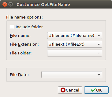

Old 02-17-2017, 10:58 AM   #134
AnselmD
Posts: 105
Join Date: Oct 2013
Name:	Screenshot from 2017-02-17 16-56-04.png
Pressing ok without changing anything gives the following error:
calibre, version 2.79.1
ERROR: Unhandled exception: <b>NameError</b>:global name 'prefs' is not defined
calibre 2.79.1 embedded-python: True is64bit: True
Linux-4.4.0-62-generic-x86_64-with-debian-stretch-sid Linux ('64bit', 'ELF')
('Linux', '4.4.0-62-generic', '#83-Ubuntu SMP Wed Jan 18 14:10:15 UTC 2017')
Python 2.7.9
Linux: ('debian', 'stretch/sid', '')
Successfully initialized third party plugins: NormComment (0, 0, 2) && BOL_DE (0, 7, 5) && EpubCheck (0, 1, 1) && Find Duplicates (1, 6, 2) && Manage Series (1, 2, 8) && Count Pages (1, 7, 0) && Search The Internet (1, 7, 6) && ANOBII (0, 4, 3) && Clean Metadata (0, 0, 6) && Barnes & Noble (1, 2, 14) && Kindle Collections (1, 7, 17) && Extract ISBN (1, 4, 4) && KindleUnpack - The Plugin (0, 81, 3) && Beam Ebooks (1, 0, 0) && Fantastic Fiction (1, 1, 6) && Modify ePub (1, 3, 13) && Goodreads (1, 1, 12) && Import List (1, 1, 5) && GetFileName (0, 0, 11) && Fantastic Fiction Adults (1, 0, 4) && FictionDB (1, 0, 10) && Quality Check (1, 9, 11)
File "site-packages/calibre/gui2/preferences/plugins.py", line 293, in customize_plugin
File "site-packages/calibre/gui2/preferences/plugins.py", line 371, in modify_plugin
File "site-packages/calibre/customize/__init__.py", line 176, in do_user_config
File "calibre_plugins.getfilename.__init__", line 275, in save_settings
File "calibre_plugins.getfilename.config", line 275, in save_settings
File "calibre_plugins.getfilename.config", line 131, in set_library_config
NameError: global name 'prefs' is not defined
AnselmD is offline   Reply With Quote
Old 02-17-2017, 11:20 AM   #135
AnselmD
Posts: 105
Join Date: Oct 2013
The file date is "new" and mandatory?
