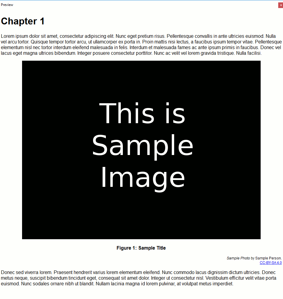

I would just handle it similar to their Book/Offline example:
<div class="entirefigure">
<div class="figureimage"><img alt="Figure 1: Sample Title" src="..\Images\Figure1.png"/></div>
<p class="figuretitle">Figure 1: Sample Title</p>
<p class="caption"><i>Sample Photo</i> by Sample Person.<br /><a href="https://creativecommons.org/licenses/by-sa/4.0/">CC-BY-SA 4.0</a>.</p>
</div>
Sample CSS:
div.entirefigure {
	margin-top: 1em;
	margin-bottom: 1em;
	page-break-inside: avoid;
div.figureimage {
	text-align: center;
	margin-left: 0;
	margin-right: 0;
p.figuretitle {
	font-weight: bold;
	text-align: center;
	margin-left: 0;
	margin-right: 0;
p.caption {
	font-size: .75em;
	text-align: right;
	margin-left: 0;
	margin-right: 0;
