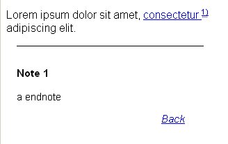

and maybe at bit OT: but why is nobody extending the link (< a > tag) so that the endnoted word itself is the hyperlink?
HTML
<p>Lorem ipsum dolor sit amet, <a  href="#fn1" id="fnref1">consectetur <span class="footnoteRef">1)</span></a> adipiscing elit. </p>
CSS
span.footnoteRef {
   text-decoration: none;
   border-bottom: 1px dotted;
   color: inherit;
   position: relative;
   top: -0.5em;
   font-size: 70%;

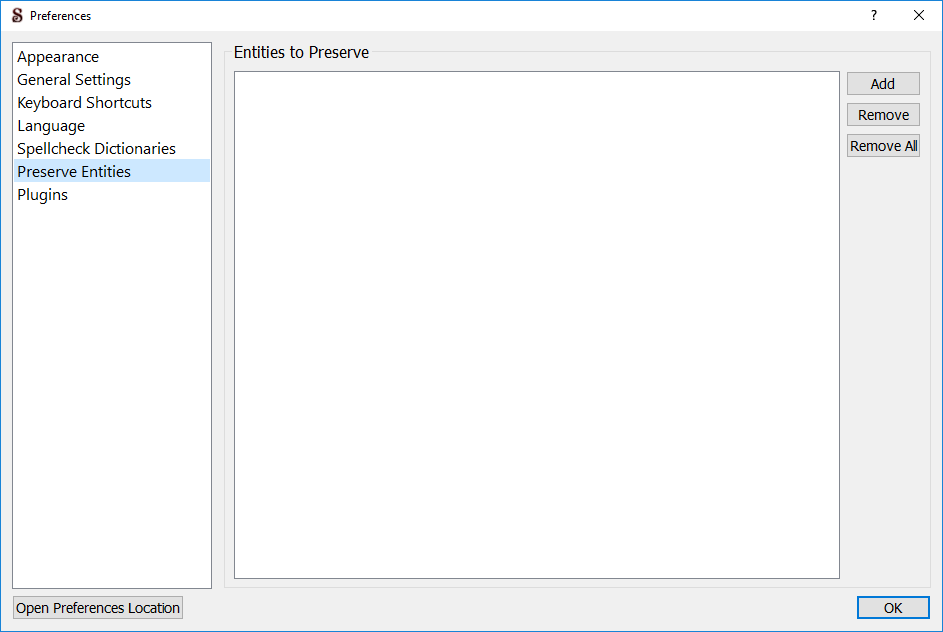

This is what I mean by "nothing set":
I just installed Sigil 0.9.6 on another computer, where Sigil has never been installed before, and yes, &nbsp; is there by default (I actually set # 160 ; in my working copy of Sigil many Sigil versions ago, since that is what I normally use. I removed it for the sake of the experiment here).
Then I installed my plugin on this virgin installation, and ran it on a file. None of the entities in the file was altered - not by running the plugin, not after a save as and reopening. I then removed the &nbsp; from the "preserve entities", closed and reopened Sigil, opened the file again and ran the plugin. Same result. I simply cannot reproduce the error. Hence I must conclude that something else is afoot.
