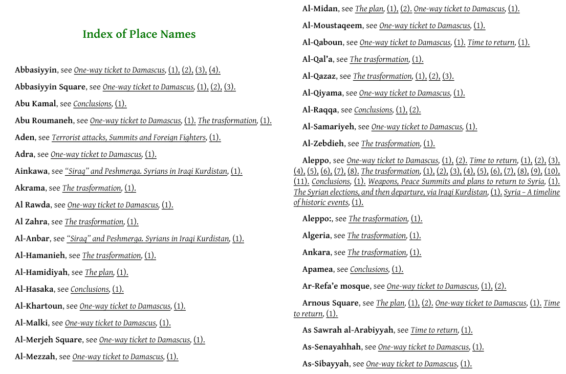

Hi, I usually create Indexes like the one I attach (a screenshot from "Syria Calling" ePub). I think this is a good way to allow reader to follow link inside the ebook and have a way to differentiate the multiple instances of a word inside a single chapter.
Name:	Schermata 2017-02-13 alle 16.10.05.png
