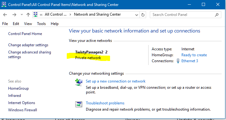

One thing to check: is the network marked as "Private"? If not then CC will not be allowed to connect.

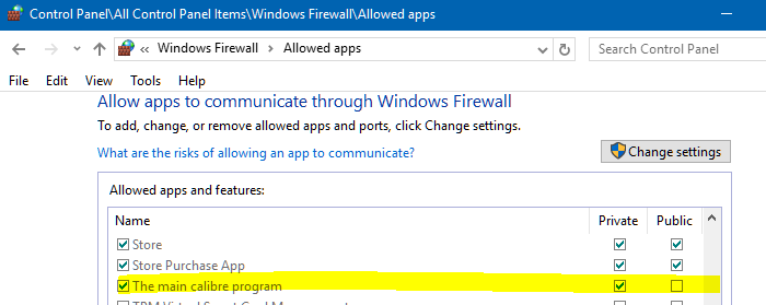

Another thing to check: is the firewall set to allow calibre access?

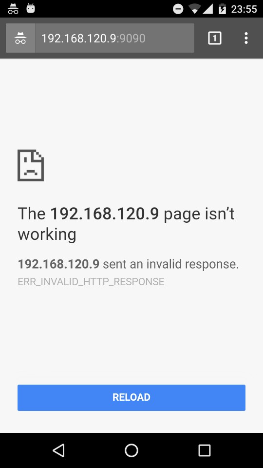

A third thing to check is to verify that I am not smoking something when I say that the device can "see" the calibre computer. Start the content server in calibre, then on the device start a browser and enter
http://ip address:CS port/
You should see something like the following.

With the content server test, and 192.168.100.4:9090 using the values I use from the wireless connection, I get
Got the error: Server Error
while trying to obtain http:192.168.100.4:9090

The content server cannot use the same port as the wireless connection. See calibre Preferences / Sharing over the net for the current port and status of the content server.

That said, "connection refused" usually says that some computer actively said "no" to the connection request. That leads us back to something on the calibre computer. For example, if on my device I attempt to connect to port 9090 (the WD port) I get this:
