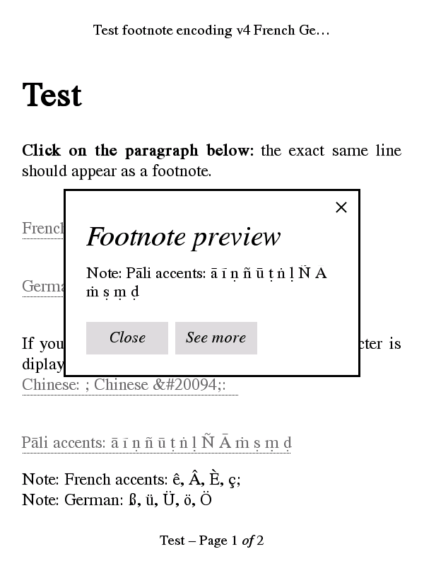

Found this old thread when looking for a way to properly display pop-up footnotes in kepubs. Unfortunately it does not work with Pali accents (used a lot in footnotes in books on Buddhism). I have attached the test epub from fxp3 with a line added for Pali accents.
Does anyone know of a workaround (maybe replacing the Georgia font used in pop-ups with a proper unicode font?)
File Type: epub Test Footnote popup encoding v4.kepub.epub (2.3 KB, 190 views)

Sorry, you don't actually say what the problem is. When I tested the book, the footnote popups showed. But, the last one showed squares for some characters. Is this the problem you mean?
If it is, some of the UI will use alternate fonts if they are loaded. For example, if the title needs a different font, if you open a book that uses that font, the title will be displayed correctly. I don't know if this is the case for the footnote popup or not. And, can't test this as I don't have a suitable font.

Yes, the problem is the squares for some of the characters (ṇ ṭ ṅ ḷ ṁ ṣ ṃ ḍ). None of the standard included fonts can display these characters. I have unicode fonts like DejaVu and Linux Libertine in my fonts directory but this only works for reading the book, not for the pop-up footnotes. Actually the Kobo has the same problem with the title in the library view, showing squares if it contains one of these characters.
OK. I'm not a font expert, but my understanding is that if you opening a book and select a font that supplies the extra characters, then the next time you visit the library lists, the titles will be shown correctly. But, that might depend on the font. And I was hoping the footnote pop up would work the same way.
The popup does showed unformatted text. It strips markup such as bold and italics, so it might not show non-standard characters. But, maybe one of the people here who use the non-supplied fonts will have an idea.
Have a look at this thread.

@ams
This is how it looks on my device (with the conflicting internal fonts deleted). The font is selected automatically, I guess, in this case it is Gandhari Unicode. Apart from the uppercase long a it seems somehow ok to me.

Thanks a lot tshering. Followed the procedure in the other thread you linked (deleting conflicting system fonts) and it works perfectly on my Mini. All characters are displayed correctly now, not only in the footnotes but also in the ToC, Library view and dictionary drop-down menu where I used to see just squares.
