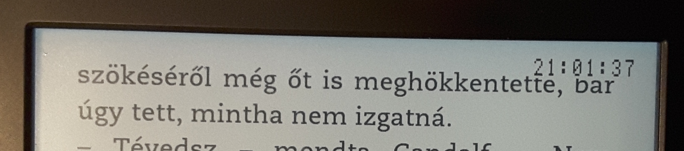

I tested it on an original Touch and a PW2. It worked on both, but unfortunately the top of the first line of text was obscured on both devices. Is it maybe possible to move the time display more to the top/decrease its font size?

As fare as I know I can't change the font or font size of the command that I use to write on the screen. I can only change the position. As I do not have a Touch the current position is not tested.

I've attached the log files and pictures for both devices (sorry for the quality). As you can see, on the PW2 only a few pixels to the top would be enough, on the Touch a little bit more.

Thanks for the quick feedback. I think about making it configurable if you what to see the battery level. Seconds make no scene at all, as they wont be right all the time.

added a new version to the first post where you can select if the time should be displayed in row 0 or row 1.
Also there is a action to copy the system log, that is used to find the page turns, into the showtime/bin directory. Start the extension on the touch, open a book, scroll some pages, got to the main menu with the wrong display, open kual as select the copy system log action. Then attach the messages.log here.
