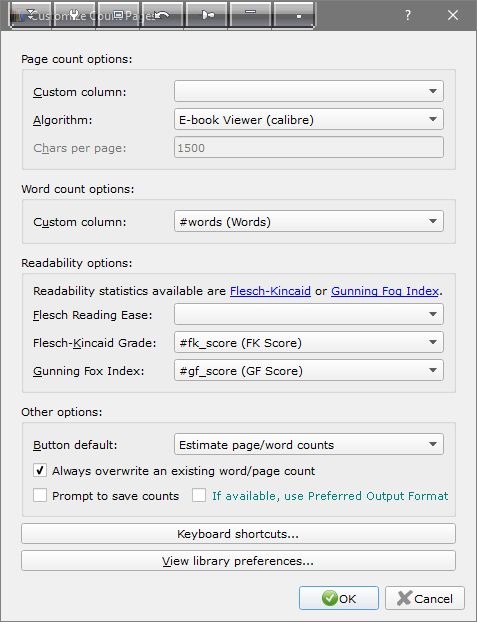

@david - here's my settings, and the option as I envisage it
IMO Pronouns shouldn't be used in labels, in tooltips okay, but in labels nay. I also prefer to put any conditional clause first, it makes the intent emphatic, putting it at the end tends to shroud it in mystery - i.e. Churchillian good, Hitchockian not. But I'll only look it at once, so it matters hardly a jot
And thanks for the +ve response.

Some users may not be familiar with the term 'Preferred Output Format'. Might it be an idea to make the label dynamic and substitute the current value of calibre prefs[output_format] into the label?
So for me the label would read 'Use EPUB if available?' whereas for a Kindle user the label would read 'Use AZW3 if available?'
The tooltip could be more specific (and also dynamic) and start something like 'Your current calibre Preferred Output Format is set to xxx. Check this option if you want the statistics to be calculated using this format if available. If not checked or xxx is not available ... etc'

If columns are not specified for the Word Count or Readability statistics, the new option should probably be disabled (greyed-out).
I suggest this for the tooltip, and/or 1st post description.
Check this option to use the format specified in the Preferred Output Format setting to calculate statistics. If that format is absent, or this option is not checked (default), statistics will be calculated using whichever of the available formats appears highest in the Preferred Input Format list. The Preferred Output and Input settings are specified in Preferences->Behaviour.
I disagree with spoon feeding users, especially on things they're only likely to use once, better to encourage them to read tooltips and/or doco. If you treat people as dummies they will behave accordingly.
