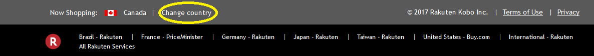

To change the country, look at the bottom of the Kobo homepage. I've attached a sample of what I see connected to the site to this message and circled (ovaled?) Change country link. Click on the Change country link to change your country.
That's not the one to use. That changes which country you are viewing, but doesn't change country associated with the account. That is done by clicking on "My Account" in the top right and selecting "Account Settings". The country is on the "Payment information". You need to put in a valid looking address in the country of choice. Unless Kobo has implemented geo-locking, that is enough to let you buy books from the new country and I assume to use the OD for that country.

Interesting. When I was looking at foreign language ebooks, changing the country and language at the bottom of the page seemed to move books in that national language to the top of my searches. I looked at changing the country under billing address but doing that required clearing payment information which left me unenthused about trying that option.
